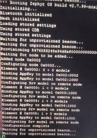

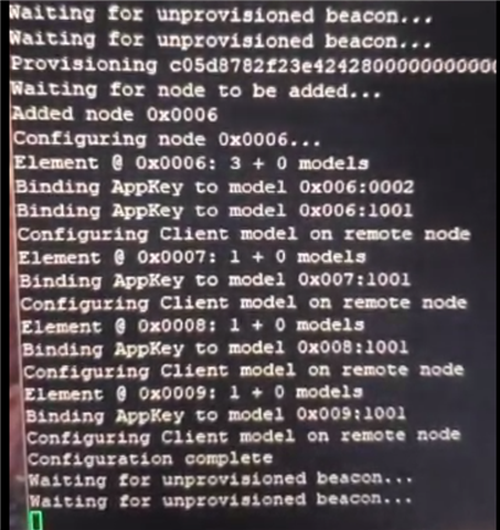

But, the switch does not turn the light node on/off anymore. I have tried completely erasing and reflashed all nodes including the provisioner, but it does not work even work once now. There is no problem in configuring the individual models. Here are the changes that I have made to the provisioner code(added comments to the sections added).

Please advice. Why did it work for the very first time? Does mesh provisioner use any fixed/static data to provision and configure? However, before I do a test I completely erase the device using the "erase board" option in nRF connect app in visual code which wipes the entire flash. So, it should not really mater even if the provisioner uses static data. Please correct me if I am wrong. Thank you.

    I am not able to test this as the embedded provisioner is using another set of keys to provision and configure the unprovisioned node. But, I was able to see the mesh model messages being transmitted using the nRF connect app.
