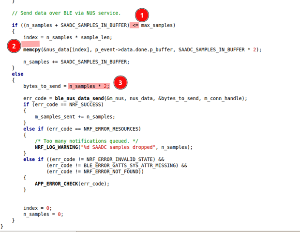

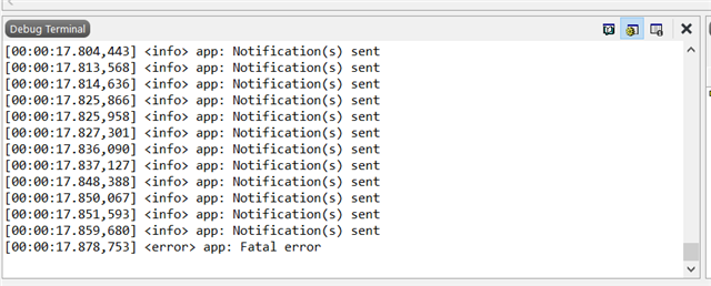

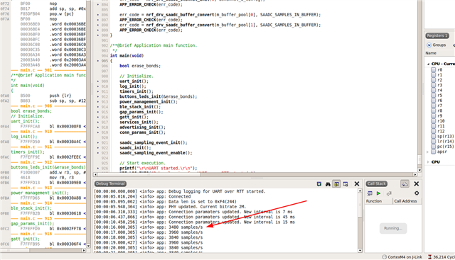

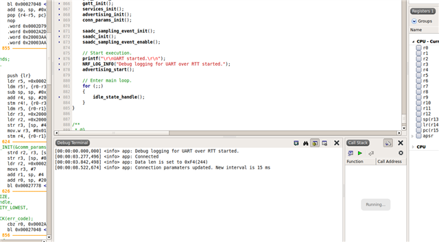

I am looking into the example of SAADC and sending data through BLE. My tests are based on this example: github.com/.../ble_app_uart__saadc_timer_driven__scan_mode
I am trying to get a higher data rate, so I changed several configurations.
#define MIN_CONN_INTERVAL MSEC_TO_UNITS(7.5, UNIT_1_25_MS)
#define MAX_CONN_INTERVAL MSEC_TO_UNITS(75, UNIT_1_25_MS)
#define SAADC_SAMPLES_IN_BUFFER         40
#define SAADC_SAMPLE_RATE               10
#define NRF_SDH_BLE_GAP_EVENT_LENGTH 40

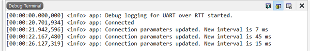

The log on my nRF Connect mobile app on Android shows an updated connection interval of 45 ms. But, when I check the detailed dssata receiving log, it shows data received every 90 ms.
My questions:
1. Does it mean I only receive one data every 90ms?
2. I want to achieve higher data rate, what can I do? My goal is ~100 kbps.
Thanks in advance!
    To further increase the throughput you can try to place the raw values inside the notification packet and skip the string conversion. Here is the result I got when I tried it here  (assuming my calculations are correct):
    Sampling @1ms
    Updated main.c:

            if ((n_samples + SAADC_SAMPLES_IN_BUFFER) < max_samples)
                index = n_samples * sample_len;
                ASSERT(!((index + sample_len) > m_ble_nus_max_data_len))
                memcpy(&nus_data[index], p_event->data.done.p_buffer, SAADC_SAMPLES_IN_BUFFER * 2);
                n_samples += SAADC_SAMPLES_IN_BUFFER;
            else
                bytes_to_send = index;
                err_code = ble_nus_data_send(&m_nus, nus_data, &bytes_to_send, m_conn_handle);
                if (err_code == NRF_SUCCESS)
                    m_samples_sent += n_samples;
                else if (err_code == NRF_ERROR_RESOURCES)
                    /* Too many notifications queued. */
                    NRF_LOG_WARNING("%d SAADC samples dropped", n_samples);
                else if ((err_code != NRF_ERROR_INVALID_STATE) &&
                        (err_code != BLE_ERROR_GATTS_SYS_ATTR_MISSING) &&
                index = 0;
                n_samples = 0;

  • No problem Slight smile  Just note that my buffer handling inside the saadc_callback() requires a bit more work. Now it will drop 4 samples every time the nus_data array is full.  A simple solution may be to use two buffers so you can start preparing the next buffer when the previous one is being transferred over BLE.
    Some other obvious mistakes I noticed when I looked at the code again:
    1. Previous check did not include the 'equal' operator so the packet would be sent before it was full (probably won't make much difference but still an optimizations you can make). 2. Removed what should be a redundant assert check. I added it to make sure I wasn't overrunning the nus_data buffer. 3. index which was used earlier is always SAADC_SAMPLES_IN_BUFFER * 2 bytes less than the number of bytes we actually want to send.
