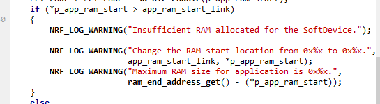

I am building a product prototype based on nrf52810 with s112 7.0.1 with NRFDK16. So the problem is the memory allocation. I setup the FLASH and RAM as per specification. But as it's said in the tutorial I'm using, when you as Custom Service this need to me changed. You should get the info in terminal emulator printed by nrf_sdh_ble_default_cfg_set function. But in my case no such a print occurs. The only print is
app_timer: RTC: initialized.
 nrf_sdh_ble: sd_ble_enable() returned NRF_ERROR_NO_MEM.
 app: Fatal error
 app: System reset

So, what should I do to see what are the exact FLASH and RAM setting I need so the app to start.
My current setting are:
FLASH_PH_START=0x0
FLASH_PH_SIZE=0x30000
RAM_PH_START=0x20000000
RAM_PH_SIZE=0x6000
FLASH_START=0x19000
FLASH_SIZE=0x17000
RAM_START=0x20001a40
RAM_SIZE=0x45c0
Thank you in advance!
    I believe you might be referring to the sd_ble_enable function. Yes, there are several things being logged there. It seems that you are using a log level such that only the errors and none of the warnings are being shown.
    To change this, please open sdk_config.h and find NRF_LOG_DEFAULT_LEVEL.

  • Thank you Elfving!
    All done and working now.
