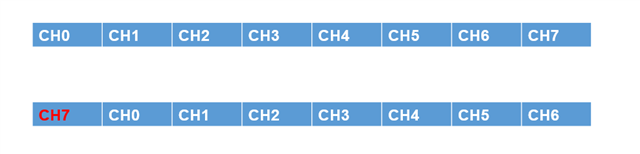

Dear Support Team,
I downloaded the code from github.com/.../ble_app_uart__saadc_timer_driven__scan_mode, modified the

file, and burned it to 52832. After running the program, I found that the ADC sampling buffer was misplaced, as shown in the screenshot below. :
The sampled data of CH7 replaces the data of CH1
How to solve this problem?
