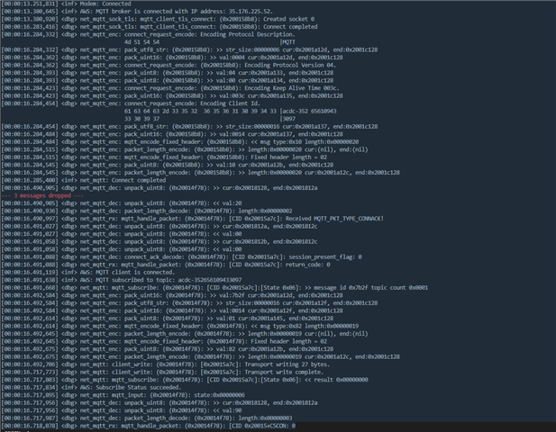

LOG freeze at mqtt
Using a NRF9160DK. SDK2.0.0. Modem 1.3.2.
I have a problem when setting up a new NRF board to run with MQTT with AWS.
When the setup is running, I get LOG <inf> for modem connect and the broker IP and then when mqtt_connect is run there are no more LOG events. (And the callback function is not activated). I have tried setting in some printk, which prints fine after the mqtt_connect. The printk sees at is get CONACK and SUBACK and that I publish to the MQTT. AWS logs also show that the publish is received and a response is created and published.
The code is borrowed from mqtt_simple. the mqtt_connect function returns errorcode 0.
The strange thing is I have 1 board running as should.
  • It is at aws.c by the 536 the log stops. when mqtt_connect is called.
    The prj.conf file

     * @param   c       The MQTT client.
     * @param   evt     The MQTT event data.
    static void aws_mqtt_event_handler(struct mqtt_client* const c, const struct mqtt_evt* evt) {
        int16_t error;
        // Reset the AWS event.
        uint8_t event = AWS_EVENT_NONE;
        // Go through the event type.
        switch(evt->type) {
            // Acknowledgement of connection request.
            case MQTT_EVT_CONNACK:
                // Has an error occurred?
                if(0 != evt->result) {
                    LOG_ERR("MQTT connection failed: %d.", evt->result);
                LOG_INF("MQTT client is connected.");
                // Subscribe the status topic to AWS.
                error = aws_subscribe(aws_mqtt_status.topic);
                if(0 > error) {
                    LOG_ERR("Subscribe Status failed: %d.", error);
                // Or has it succeeded?
                else {
                    LOG_INF("Subscribe Status succeeded.");
            // Disconnection event.
            case MQTT_EVT_DISCONNECT:
                LOG_INF("MQTT client is disconnected.");
                atomic_set(&is_connect_requested, 0);
            // Publish event received when message is published on a topic client is subscribed to.
            case MQTT_EVT_PUBLISH: {
                // Read the parameters for the publish message.
                const struct mqtt_publish_param* p = &evt->param.publish;
                LOG_INF("MQTT PUBLISH result = %d, length = %d.", evt->result, p->message.payload.len);
                // Is QoS set to MQTT_QOS_1_AT_LEAST_ONCE?
                if(MQTT_QOS_1_AT_LEAST_ONCE == p->message.topic.qos) {
                    // Prepare the QoS1 ack message.
                    const struct mqtt_puback_param ack = {
                        .message_id = p->message_id
                    // Send the ack message.
                    error = mqtt_publish_qos1_ack(&client, &ack);
                    if(0 != error) {
                        LOG_ERR("MQTT publish QoS1 ack failed: %d.", error);
                // Is QoS set to MQTT_QOS_2_EXACTLY_ONCE?
                else if(MQTT_QOS_2_EXACTLY_ONCE == p->message.topic.qos) {
                    // Prepare the QoS2 receive message.
                    const struct mqtt_pubrec_param receive = {
                    // Send the receive message.
                    error = mqtt_publish_qos2_receive(&client, &receive);
                    if(0 != error) {
                        LOG_ERR("MQTT publish QoS2 receive failed: %d.", error);
                // Read the published MQTT payload.
                error = aws_mqtt_publish_get_payload(c, p->message.payload.len);
                if(0 != error) {
                    LOG_ERR("MQTT PUBLISH payload failed: %d.", error);
                // Has the payload been read successfully?
                LOG_INF("MQTT PUBLISH topic: %s.", log_strdup(p->message.topic.topic.utf8));
                // Has an AWS status topic occurred?
                if(0 == strcmp(p->message.topic.topic.utf8, aws_mqtt_status.topic)) {
                    // Set the AWS response ready event.
                    event = AWS_EVENT_RESPONSE_READY;
                // Or is the response unknown?
                else {
                    LOG_INF("MQTT PUBLISH response is unknown.");
            // Acknowledgement for published message with QoS 1.
            case MQTT_EVT_PUBACK:
                    LOG_ERR("MQTT PUBACK received error: %d.", evt->result);
                LOG_INF("MQTT PUBACK received with id: %u.", evt->param.puback.message_id);
            // Reception confirmation for published message with QoS 2.
            case MQTT_EVT_PUBREC: {
                    LOG_ERR("MQTT QoS2 PUBREC received error: %d.", evt->result);
                // Read the parameters for the pubrec message.
                const struct mqtt_pubrec_param* p = &evt->param.pubrec;
                // Prepare the release message.
                const struct mqtt_pubrel_param release = {
                // Send the release message.
                error = mqtt_publish_qos2_release(&client, &release);
                if(0 != error) {
                    LOG_ERR("MQTT publish QoS2 release failed: %d.", error);
                LOG_INF("MQTT PUBREC received with id: %u.", p->message_id);
            // Release of published message with QoS 2.
            case MQTT_EVT_PUBREL: {
                    LOG_ERR("MQTT QoS2 PUBREL received error: %d.", evt->result);
                // Read the parameters for the pubrel message.
                const struct mqtt_pubrel_param* p = &evt->param.pubrel;
                // Prepare the complete message.
                const struct mqtt_pubcomp_param complete = {
                // Send the complete message.
                error = mqtt_publish_qos2_complete(&client, &complete);
                if(0 != error) {
                    LOG_ERR("MQTT publish QoS2 complete failed: %d.", error);
                LOG_INF("MQTT PUBREL received with id: %u.", p->message_id);
            // Confirmation to a publish release message with QoS 2.
            case MQTT_EVT_PUBCOMP: {
                    LOG_ERR("MQTT PUBCOMP received error: %d.", evt->result);
                LOG_INF("MQTT PUBCOMP received with id: %u.", evt->param.pubcomp.message_id);
            // Acknowledgement to a subscribe request.
            case MQTT_EVT_SUBACK:
                    LOG_ERR("MQTT SUBACK received error: %d.", evt->result);
                LOG_INF("MQTT SUBACK received with id: %u.", evt->param.suback.message_id);
                aws_mqtt_status.is_subscribed = true;
            // Acknowledgment to a unsubscribe request.
            case MQTT_EVT_UNSUBACK:
                    LOG_ERR("MQTT UNSUBACK received error: %d.", evt->result);
                LOG_INF("MQTT UNSUBACK received with id: %u.", evt->param.unsuback.message_id);
                aws_mqtt_status.is_subscribed = false;
            // Ping Response from server.
            case MQTT_EVT_PINGRESP:
            default:
        // Has a AWS callback been set?
        if((AWS_EVENT_NONE != event) && (NULL != aws_callback)) {
            // Set the callback function.
            aws_callback(event, mqtt_payload_buffer);
     * @brief   Initialize the MQTT broker structure.
    static void aws_broker_init(void) {
        // Fill out the initial address info struct.
        struct addrinfo hints = {
            .ai_flags = 0,
            .ai_family = AF_INET,
            .ai_socktype = SOCK_STREAM,
            .ai_protocol = 0,
        // The resulting address info struct.
        struct addrinfo* result;
        struct addrinfo* address;
        // Convert text strings representing hostnames/IP addresses into a linked list of struct addrinfo structure.
        int error = getaddrinfo(BROKER_HOSTNAME, NULL, &hints, &result);
        // Did an error occur?
        if(0 != error) {
            LOG_ERR("Getaddrinfo failed, error: %d.", errno);
            return;
        // Store the resulting address info.
        address = result;
        // Look for the IPv4 Address of the broker.
        while(NULL != address) {
            // Is it an IPv4 Address?
            if(sizeof(struct sockaddr_in) == address->ai_addrlen) {
                // Initialize the broker structure.
                struct sockaddr_in* broker = ((struct sockaddr_in*)&mqtt_broker);
                // Fill out the socket IPv4 address for the broker.
                broker->sin_addr.s_addr = ((struct sockaddr_in*)address->ai_addr)->sin_addr.s_addr;
                broker->sin_family = AF_INET;
                broker->sin_port = htons(MQTT_BROKER_PORT);
                // An array holding the IP address.
                char ipv4_address[NET_IPV4_ADDR_LEN];
                // Convert the IP address from internal to numeric ASCII form.
                inet_ntop(AF_INET, &broker->sin_addr.s_addr, ipv4_address, sizeof(ipv4_address));
                LOG_INF("MQTT broker is connected with IP address: %s.", log_strdup(ipv4_address));
            // Increment the address pointer.
            address = address->ai_next;
        // Free the resulting memory struct.
        freeaddrinfo(result);
    void aws_init(const uint8_t* const _client_id, const aws_event_callback_t _callback) {
        aws_callback = _callback;
        // Initialize the MQTT client instance.
        mqtt_client_init(&client);
        // MQTT client configuration.
        client.broker = &mqtt_broker;
        client.evt_cb = aws_mqtt_event_handler;
        client.client_id.utf8 = _client_id;
        client.client_id.size = strlen(client.client_id.utf8);
        client.password = NULL;
        client.user_name = NULL;
        client.protocol_version = MQTT_VERSION_3_1_1;
        // MQTT buffers configuration.
        client.rx_buf = mqtt_rx_buffer;
        client.rx_buf_size = sizeof(mqtt_rx_buffer);
        client.tx_buf = mqtt_tx_buffer;
        client.tx_buf_size = sizeof(mqtt_tx_buffer);
        // MQTT transport configuration.
        client.transport.type = MQTT_TRANSPORT_SECURE;
        // The security tag.
        static sec_tag_t sec_tag_list[] = { CC_MODEM_CERTIFICATE_SEC_TAG };
        // TLS configuration for secure MQTT transports.
        struct mqtt_sec_config* tls_config = &(client.transport).tls.config;
        tls_config->peer_verify = 2;
        tls_config->cipher_count = 0;
        tls_config->cipher_list = NULL;
        tls_config->sec_tag_count = ARRAY_SIZE(sec_tag_list);
        tls_config->sec_tag_list = sec_tag_list;
        tls_config->hostname = BROKER_HOSTNAME;
        tls_config->session_cache = TLS_SESSION_CACHE_DISABLED;
        // Fill out the MQTT status topic struct.
        aws_mqtt_status.topic = (uint8_t*)_client_id;
        aws_mqtt_status.failure_message = "FAILURE";
        aws_mqtt_status.success_message = "SUCCESS";
        aws_mqtt_status.qos = "1";
        // Initialize a mutex.
        k_mutex_init(&aws_publish_mutex);
        // Initialize a work queue.
        k_work_init(&aws_publish_work, aws_publish_work_handler);
    void aws_connect(void) {
        // Is the connection already requested?
        if(1 == atomic_get(&is_connect_requested)) {
            return;
        // Initialize the MQTT broker.
        aws_broker_init();
        // Connect to the MQTT broker.
        int error = mqtt_connect(&client);
        if(0 != error) {
            LOG_ERR("MQTT connection failed: %d.", error);
            return;
        // Set the MQTT transport to secure.
        mqtt_pollfd.fd = client.transport.tls.sock;
        mqtt_pollfd.events = POLLIN;
        // The connection is now requested.
        atomic_set(&is_connect_requested, 1);
    // cppcheck-suppress    unusedFunction
    void aws_disconnect(void) {
        // Is the connection not requested?
        if(0 == atomic_get(&is_connect_requested)) {
            return;
        // Disconnect from the MQTT broker.
        int error = mqtt_disconnect(&client);
        if(0 != error) {
            LOG_ERR("MQTT disconnection failed: %d.", error);
    bool aws_is_connection_requested(void) {
        return (bool)atomic_get(&is_connect_requested);
    void aws_run(void) {
        // Wait on an event on the file descriptor.
        int error = poll(&mqtt_pollfd, 1,  mqtt_keepalive_time_left(&client));
        if(0 > error) {
            LOG_ERR("MQTT poll failed: %d.", errno);
            return;
        // Keep the connection alive by sending a ping request.
        error = mqtt_live(&client);
        if((0 != error) && (-EAGAIN != error)) {
            LOG_ERR("MQTT live failed: %d.", error);
            return;
        // Is there data to read (returned event)?
        if(POLLIN == (mqtt_pollfd.revents & POLLIN)) {
            // Receive an incoming MQTT packet. The registered callback will be called with the packet content.
            error = mqtt_input(&client);
            if(0 != error) {
                LOG_ERR("MQTT input failed: %d.", error);
                return;
        // Does the returned event contain an error condition?
        if(POLLERR == (mqtt_pollfd.revents & POLLERR)) {
            LOG_ERR("MQTT failed with POLLERR.");
            return;
        // Does the returned event contain an invalid request?
        if(POLLNVAL == (mqtt_pollfd.revents & POLLNVAL)) {
            LOG_ERR("MQTT failed with POLLNVAL.");
            return;
    int16_t aws_subscribe(const char* const _subscribe_topic) {
        // Is the topic already subscribed?
        if(true == aws_mqtt_status.is_subscribed) {
            return 0;
        // Create the subscribed topic.
        struct mqtt_topic topic = {
            .topic = {
                .utf8 = _subscribe_topic,
                .size = strlen(_subscribe_topic)
            .qos = MQTT_QOS_1_AT_LEAST_ONCE
        // Add the topic to the subscription request.
        const struct mqtt_subscription_list subscription_list = {
            .list = &topic,
            .list_count = 1,
            .message_id = sys_rand32_get()
        LOG_INF("MQTT subscribed to topic: %s", log_strdup(_subscribe_topic));
        // Subscribe to the topic.
        return mqtt_subscribe(&client, &subscription_list);
    void aws_publish(const char* const _topic, const uint8_t* const _data) {
        // Lock the AWS publish mutex and has it succeeded?
        if(0 != k_mutex_lock(&aws_publish_mutex, K_MSEC(CC_WORK_MUTEX_LOCK_TIMEOUT_MS))) {
            LOG_ERR("AWS publish mutex cannot be locked.");
            return;
        // Store the AWS publish information.
        aws_publish_info.topic = (char*)_topic;
        aws_publish_info.data = (uint8_t*)_data;
        // Unlock the AWS publish mutex.
        (void)k_mutex_unlock(&aws_publish_mutex);
        // Submit a work item to the system work queue.
        (void)k_work_submit(&aws_publish_work);
    void aws_get_status(aws_mqtt_status_t* _aws_mqtt_status) {
        // Get the AWS MQTT status struct.
        memcpy(_aws_mqtt_status, &aws_mqtt_status, sizeof(aws_mqtt_status));

  • This is what I get in return. It still wont do anything after this.
  • This is what the terminal respons with. The log is still not responding on events hapening after.
  • Hm I see, could you please share your git repo, it would be easier for us to try running the code locally that way.
    -Einar
