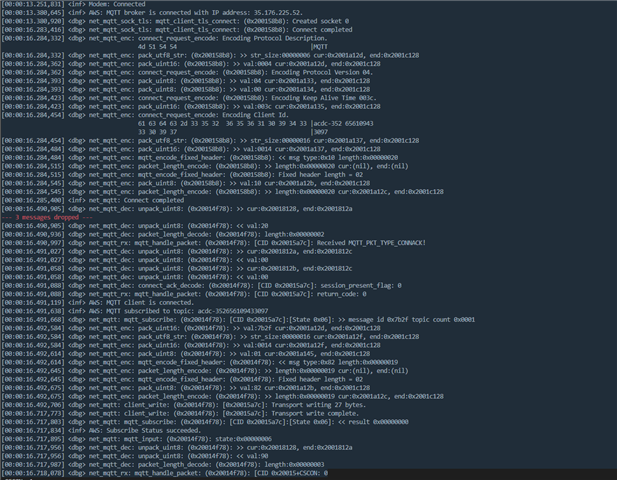

LOG freeze at mqtt
Using a NRF9160DK. SDK2.0.0. Modem 1.3.2.
I have a problem when setting up a new NRF board to run with MQTT with AWS.
When the setup is running, I get LOG <inf> for modem connect and the broker IP and then when mqtt_connect is run there are no more LOG events. (And the callback function is not activated). I have tried setting in some printk, which prints fine after the mqtt_connect. The printk sees at is get CONACK and SUBACK and that I publish to the MQTT. AWS logs also show that the publish is received and a response is created and published.
The code is borrowed from mqtt_simple. the mqtt_connect function returns errorcode 0.
The strange thing is I have 1 board running as should.
