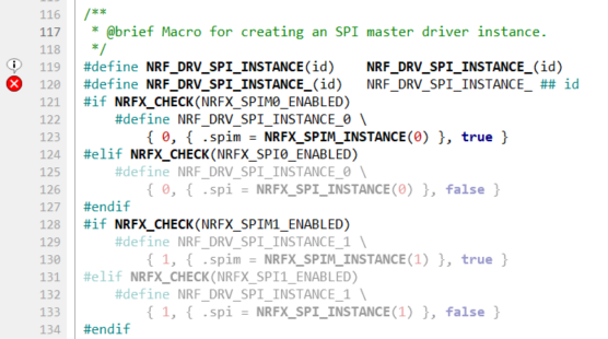

Issue with setting up two SPI instances. Error: 'NRF_DRV_SPI_INSTANCE_1' undeclared here (not in a function); did you mean 'NRF_DRV_SPI_INSTANCE_0'?
I want to use two SPI instances (0 and 1) in my project. I am able to modify the example SPI project to use 2 SPI instances as in the code below and setting #define SPI1_ENABLED 1 in sdk_config.h.
#define SPI_INSTANCE0  0 /**< SPI instance index. */
static const nrf_drv_spi_t spi0 = NRF_DRV_SPI_INSTANCE(SPI_INSTANCE0);  /**< SPI instance. */
#define SPI_INSTANCE1  1 /**< SPI instance index. */
static const nrf_drv_spi_t spi1 = NRF_DRV_SPI_INSTANCE(SPI_INSTANCE1);  /**< SPI instance. */
I can then go on and configure SPI_1 similar to the example for SPI_0.
However, when I try to add a second SPI instance to a project I have already been working on, I get the following compilation error:

I have ensured that the relevant parts of sdk_config.h for nrf_drv_spi and nrfx_spi match in the example and my project (attached).
I am not using TWI which is the only peripheral that shares a base address with the SPI instances.
I would like to be able to fix my existing project and understand what is causing this error as the project is quite large and starting from scratch would be time consuming.

    If you disable the SPI0 instance and only initialize instance 1, does it still complain?
    Also, there isn't a chance that you're using PCA10040e folder instead of PCA10040? The former is for the nRF52810 emulated on the nRF52832 which only have SPI0.
    regards
    Jared
  • Hi Jared,
    I tried disabling instance 0 and only initializing instance 1 and I get the same error.
    Yes, I'm using PCA10040 folder.
    Another thing I noticed is in nrf_drv_spi.h, #define NRF_DRV_SPI_INSTANCE_1 is not reached. I have SPI0 and SPI1 configured the same in sdk_config.h so I don't understand why the #if directive behaves differently for both.
    I found out from other questions on this topic that apply_old_config.h will overwrite NRFX_SPIM0/1 depending on if USE_EASY_DMA is enabled or not in sdk_config.h. I'm copying the relevant parts from sdk_config.h below.

    I have also tried changing NRFX_SPI0/1_ENABLED to 1
    I'm not sure what you're doing wrong but I did a quick test and tried duplicating the SPI example by adding a second instance to it. My short testing showed that it worked. Here is config and main file I used. Note that this is not good nor efficient code, it was just to check if it worked or not. I would not base any future project on this example Slight smile
    maybe you could diff the files with your project and see if you find any notable differences?

    // <e> SPI_ENABLED - nrf_drv_spi - SPI/SPIM peripheral driver - legacy layer
    #ifndef SPI_ENABLED
    #define SPI_ENABLED 1
    // <o> SPI_DEFAULT_CONFIG_IRQ_PRIORITY  - Interrupt priority
    // <i> Priorities 0,2 (nRF51) and 0,1,4,5 (nRF52) are reserved for SoftDevice
    // <0=> 0 (highest)
    // <1=> 1
    // <2=> 2
    // <3=> 3
    // <4=> 4
    // <5=> 5
    // <6=> 6
    // <7=> 7
    #ifndef SPI_DEFAULT_CONFIG_IRQ_PRIORITY
    #define SPI_DEFAULT_CONFIG_IRQ_PRIORITY 6
    // <o> NRF_SPI_DRV_MISO_PULLUP_CFG  - MISO PIN pull-up configuration.
    // <0=> NRF_GPIO_PIN_NOPULL
    // <1=> NRF_GPIO_PIN_PULLDOWN
    // <3=> NRF_GPIO_PIN_PULLUP
    #ifndef NRF_SPI_DRV_MISO_PULLUP_CFG
    #define NRF_SPI_DRV_MISO_PULLUP_CFG 1
    // <e> SPI0_ENABLED - Enable SPI0 instance
    #ifndef SPI0_ENABLED
    #define SPI0_ENABLED 1
    // <q> SPI0_USE_EASY_DMA  - Use EasyDMA
    #ifndef SPI0_USE_EASY_DMA
    #define SPI0_USE_EASY_DMA 1
    // </e>
    // <e> SPI1_ENABLED - Enable SPI1 instance
    #ifndef SPI1_ENABLED
    // <q> SPI1_USE_EASY_DMA  - Use EasyDMA
    #ifndef SPI1_USE_EASY_DMA
    #define SPI1_USE_EASY_DMA 1
    // </e>
    // <e> SPI2_ENABLED - Enable SPI2 instance
    #ifndef SPI2_ENABLED
    #define SPI2_ENABLED 0
    // <q> SPI2_USE_EASY_DMA  - Use EasyDMA
    #ifndef SPI2_USE_EASY_DMA
    #define SPI2_USE_EASY_DMA 1
    #ifndef SPI_ENABLED
    // <0=> 0 (highest)
    // <1=> 1
    // <2=> 2
    // <3=> 3
    // <4=> 4
    // <5=> 5
    // <6=> 6
    // <7=> 7
    // </e>
    // </e>
    // </e>
