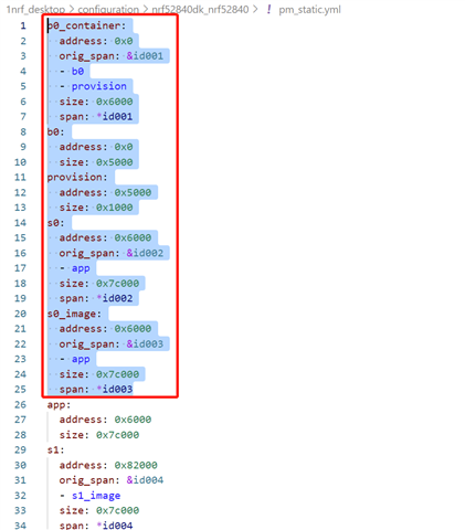

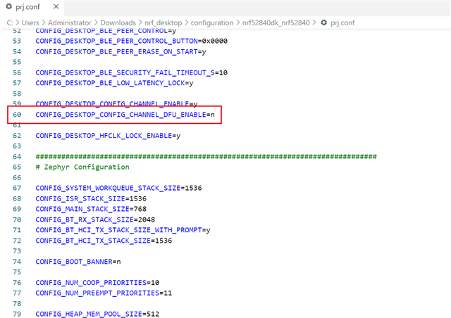

So I off this config on nrf\applications\nrf_desktop\configuration\nrf52840dk_nrf52840\prj.conf.

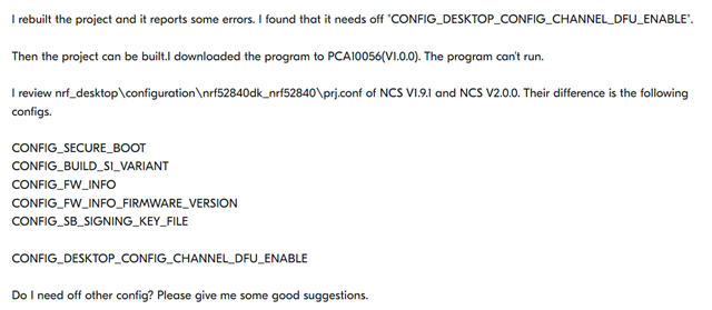

I rebuilt the project and it reports some errors. I found that it needs off "CONFIG_DESKTOP_CONFIG_CHANNEL_DFU_ENABLE".
Then the project can be built.I downloaded the program to PCA10056(V1.0.0). The program can't run.
I review nrf_desktop\configuration\nrf52840dk_nrf52840\prj.conf of NCS V1.9.1 and NCS V2.0.0. Their difference is the following configs.
CONFIG_SECURE_BOOT
CONFIG_BUILD_S1_VARIANT
CONFIG_FW_INFO
CONFIG_FW_INFO_FIRMWARE_VERSION
CONFIG_SB_SIGNING_KEY_FILE
Do I need off other config? Please give me some good suggestions.

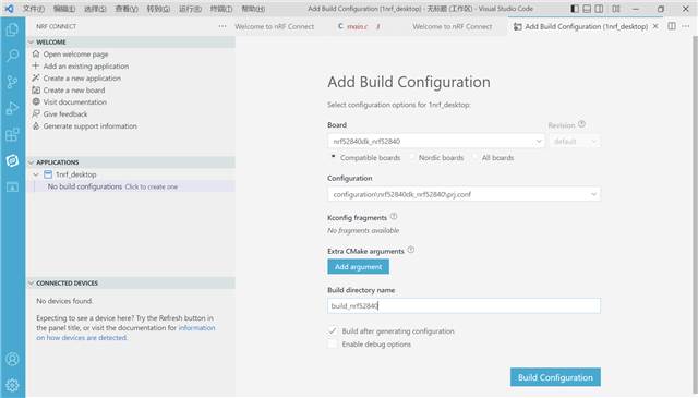

  • Dear Dejans
    The following log is  only setting CONFIG_SECURE_BOOT=n

  • Dear Dejans
    1. You can delete my build files and rebuild a new build project for nrf52840dk.
    2. "CONFIG_DESKTOP_CONFIG_CHANNEL_DFU_ENABLE" is a default config of nrf_desktop.
    Its default config is "CONFIG_DESKTOP_CONFIG_CHANNEL_DFU_ENABLE=y".
    So you should look for it to prj.conf's line 60.
    3. Yes, merged2.hex does not turn ON any LEDs and you can't use phone or PC's bluetooth scan advertising of DK.
    I tried to three PCs to build and test nrf_desktop for this problem. This problem reappears every time.
    So I think this problem is a bug of NCS 2.0.0.
    4. You can use your PC and PCA10056(v1.0.0) to copy this way.
    You only close "CONFIG_DESKTOP_CONFIG_CHANNEL_DFU_ENABLE" and "CONFIG_SECURE_BOOT" in your prj.conf of nrf_desktop.
    Then build the project and download program to PCA10056(v1.0.0).
    This problem will recurrence.
    Best regards.
