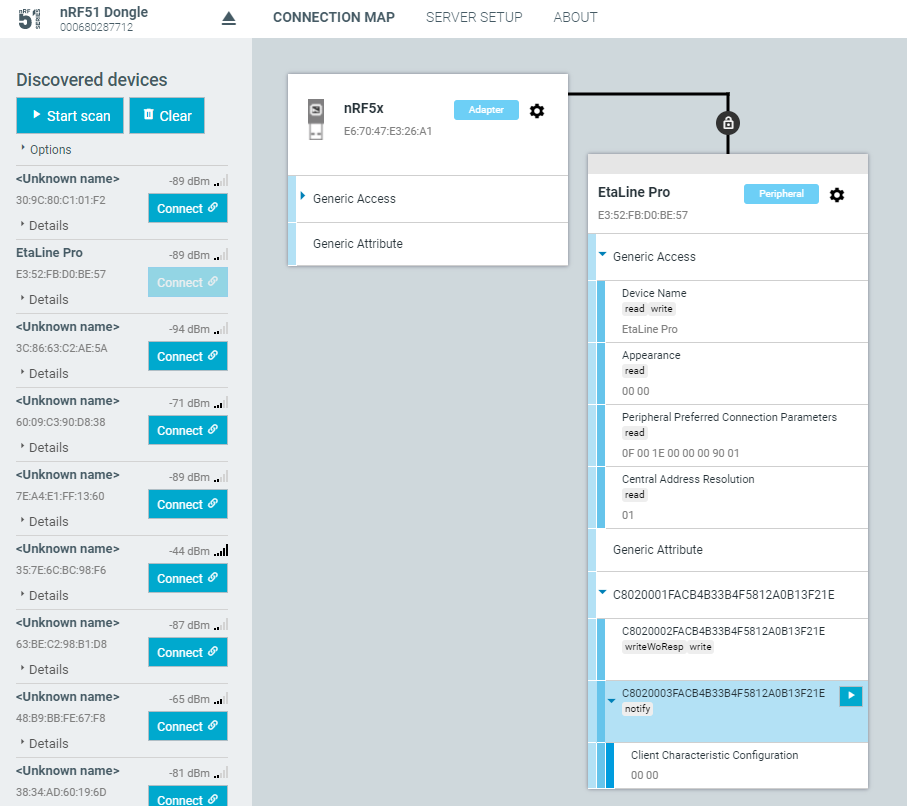

  • Thank you for the clarification.
    I wanted some basic clarifications on the examples that Nordic has put on the SDKs (for example "nRF5_SDK_15.3.0_59ac345")
    and which I have used as a basis to use with nRF52832.
    The example projects I used are these (peripheral and central):
    1) .... \ Nordic-SDK \ nRF5_SDK_15.3.0_59ac345.zip \ nRF5_SDK_15.3.0_59ac345 \ examples \ ble_peripheral \ ble_app_uart \
    2) .... \ Nordic-SDK \ nRF5_SDK_15.3.0_59ac345.zip \ nRF5_SDK_15.3.0_59ac345 \ examples \ ble_central \ ble_app_uart_c \
    In the first project (peripheral) the UUID and name have been changed and downloaded in the Nordic EVAL with nRF52832.
    With the u-blox tools "nRF Connector for Desktop v.3.11" I have the possibility to see the BLE network.
    Below I show you what you see.
    From this tools I can send and receive data that I will see in the VCP present in the EVAL and it works correctly.
    First you talk about NUS.
    But isn't my modified Nordic project already a UART over BLE (NUS) ?
    Let me know.
    Thank you
    BR
    Demetrio Magrin

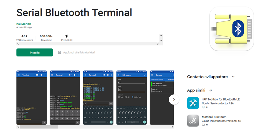

  • Hello Hung Bui,
    thank you for your help.
    Before wasting your time I'll tell you this to simplify the problem:
    I already have an application that uses nRF52832 with the start project ... \ Nordic-SDK \
    nRF5_SDK_15.3.0_59ac345.zip\nRF5_SDK_15.3.0_59ac345\ examples\ ble_peripheral\ ble_app_uart\.
    As BLE central I am using a free APP on Android which is called "Serial Bluetooth Terminal" and which you
    can download freely.
    With this APP I can communicate via BLE with my application that uses nRF52832 and send and receive data
    without any problem.
    I would like to do the same thing with u-blox NINA-B2xx module.
    At present I have not been able with the "Serial Bluetooth Terminal" program, it recognizes the NINA-B2xx module of the u-blox but I cannot make the connection between the two devices.
    Note: To keep it simple I used the same UUID on both of the two solutions.
    From you I just need to know if the u-blox NINA-B2xx module can connect with the "Serial Bluetooth Terminal" APP.
    For the remaining problems I am looking for help to support u-blox.
    Let me know.
    I thank you.
    Magrin Demetrio
