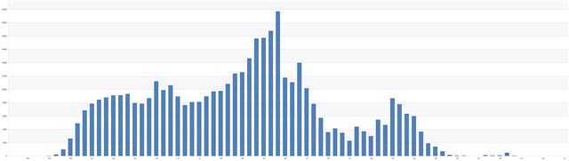

The attached picture below captures all the RSSI of our beacons in the field. These devices were set to transmit at maximum transmit power of +4dBm. This max value was set as we wanted to maximize the coverage and we were afraid of shadowing (pathloss) problems.
Histogram of RSSI

  1. We would like to improve the battery life of the beacons by configuring the transmit power to 0dBm. Then, how much of the RSSI can we expect to lose in the above chart? Will the expected lowest RSSI value be -85 or -80 or something else? Your input will help us configure our deployed network better.
  2. I am unable to explain why there is dip in the RSSI for values between -46 and -56. If possible, based on Nordic's experience, please help me understand why there could be a dip here at these healthy values of RSSI. Note that this is years of data.

    First off, you shouldn't base too much off of the RSSI values you see, as these will only give an indication of what the sensitivity is, and not be very accurate. I would recommend testing that you receive the expected data at the range you're looking for instead of basing your tests off RSSI alone. As I don't know what your application/ use case is, I'm not sure what to recommend. What range is the application going to operate in, and in what kind of environment?
    1. Yes, you will get worse RSSI values when decreasing the TX power, but if you're still happy with the effective range you get at 0dBm this should be fine. The RSSI will vary a lot depending on what environment you're testing in, so I can't come with an expected RSSI number I'm afraid.
    2. I think this is just random as RSSI is not too reliable for measurement. I'm sure if you do the same test again the highs and lows will be different.

  • Thank you Simon for your detailed comments. The range is expected to be in a typical indoor environment where the assets can move and can experience shadowing effects with people moving around or constantly shadowing the line of sight communication.
    As RSSI does not seem reliable, please suggest suitable alternatives to RSSI.
  • Do you need RSSI or something similar in your application? For testing you should set the devices up in a control environment and make sure that the packets are transmitted and received at a satisfactory success rate. Using a receiver that acknowledges and prints out the transmitted data so you can see. If you get the expected data at 0dBm TX power there's no need to use 4dBm in your application. The environment you describe shouldn't require more than 0dBm in my experience.
