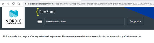

    PS the link you paste seems not working ...
  • Hi Abele,
    Thanks for letting me know. For some reason DevZone changed the link to try to link to something on DevZone instead. I have updated the link, but it is also here: https://infocenter.nordicsemi.com/topic/sdk_tz_v4.1.0/zigbee_r22_migration.html.

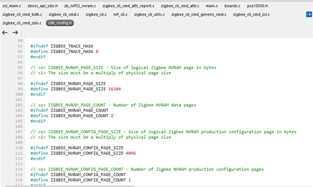

    abe said:
    The question about the needed amount of NVRAM for 100 end node,
    This depends on the application, the network configuration and how often the data needs to be stored in the flash memory. If the configuration of the network is to be changed often, it would be smart to increase the flash memory allocated for the ZBOSS NVRAM.
    The default value should be sufficient unless you actually plant to connect so many devices to the network. But if that is the case, you should double the NVRAM memory capacity.
    I'm not sure to good understand this answer ... when a End Node is joined by the coordinator there are some parameters stored into Zboss Nvram. If I have 100 different nodes in the network, this NVRAM amount is enough?
