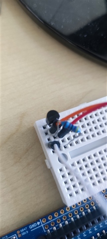

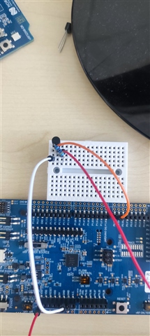

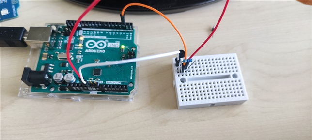

Also, pics of my connections :
The problem is the same for the three methods.
What I observe is that, during the reading part, it only reads high state values (=0xFF).
I thought the problem was from the time slots of my functions. But I tried dfiferent configurations and none of them worked.
I also tried with different flags for the pin configuration (in sensor.c) : GPIO_OUTPUT, GPIO_OUTPUT_INIT_LOW, GPIO_OUTPUT_INACTIVE. With no effects.
I am strating thinking the issue comes from the hard but I can't see what I am doing wrong.
For now, I'm still thinking the problem comes from one of thoses :
- The hard (my connections aren't correct)
- The pin configuration (but ds18b20.c should work as I didn't touch the pin configuration in this one).
- Maybe the k_sleep function but I woudn't understand why.
Do anyone have an idea ?
Thanks in advance for you help !
Sulian
