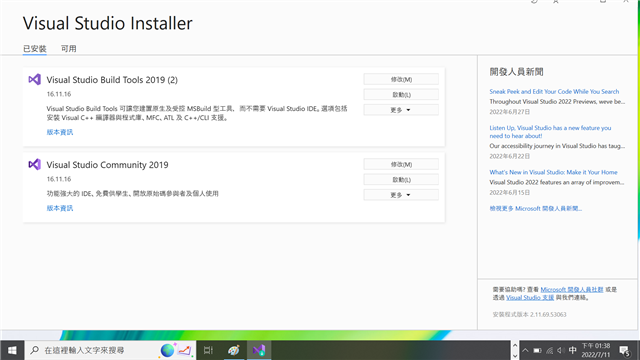

  • But command "cmake --build ." is failed.
    c:
    cd C:\Program Files (x86)\Microsoft Visual Studio\2019\Community\VC\Auxiliary\Build
    vcvars64.bat
    d:
    cd D:\pc-ble-driver\
    mkdir build
    cd build
    cmake -G Ninja ..
    cmake --build .
    C:\Program Files (x86)\Microsoft Visual Studio\2019\Community\VC\Tools\MSVC\14.29.30133\include\yvals_core.h(575): fatal error C1189: #error:  STL1001: Unexpected compiler version, expected MSVC 19.29 or newer.

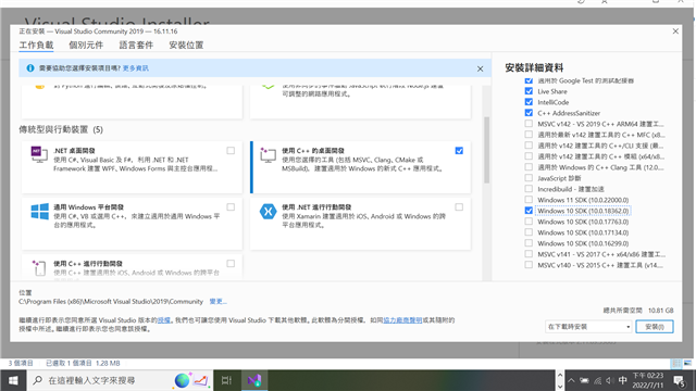

    Have you tried to update MSVC to the expected version  ?
  • My visual studio is 2019. Its msvc should already expected version.
  • C:\Program Files (x86)\Microsoft Visual Studio\2019\Community\VC\Auxiliary\Build>cl.exe --version
    Microsoft (R) C/C++ Optimizing Compiler Version 19.29.30145 for x64
  • Thanks for your help! I can build pc-ble-driver DLL after I reinstall same version of compiler and SDK of Visual Studio 2019.
