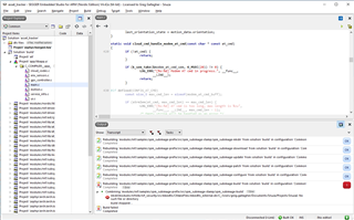

I am busy evaluating the nRF9160, but when he builds his project he's getting the following error.
mkdir(modules/nrfxlib/nrf_security/src/mbedtls/CMakeFiles/mbedtls_external.dir/C_/Users/greg.gallagher/Documents/xxxxx/Projects/xxxxx): No such file or directory
I then zipped my whole ncs folder and sent it to him, but when he builds his project it comes up with the same error.
Is there something that we can suggest he try to fix the problem?

    Has your client done anything to his NCS install, or is it a clean install using the Getting Started Assistant? Is the Asset Tracker application untouched? In SES, what does nRF Connect Options look like (Tools --> Options --> nRF Connect)

    mkdir(modules/nrfxlib/nrf_security/src/mbedtls/CMakeFiles/mbedtls_external.dir/C_/Users/greg.gallagher/Documents/Snuza/Projects/Snuza)
    It looks like the compiler tries to add an extra path to the end. If not able to find the cause, can your customer try to re-init the git repository?

    We finally got his code to compile, it was his directory path that was too long.
    I saw in the error message that it didn't list his full path and then compared it to mine.
    He moved his whole folder to the root and then it worked.
