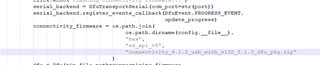

I have checked the directory below:
/Library/Frameworks/Python.framework/Versions/3.10/lib/python3.10/site-packages/pc_ble_driver_py/hex/sd_api_v5/
The file named "connectivity_4.1.2_usb_with_s132_5.1.0_dfu_pkg.zip" does not exist, but there is a file named "connectivity_4.1.4_usb_with_s132_5.1.0_dfu_pkg.zip"?
I'm not sure is it a bug? or something wrong?
