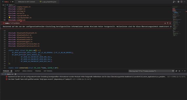

After starting a new application from an existing sample (peripheral_hr), Visual Studio Code outputs following error messages. "kobj-types-enum.h cannot be opened."
Sorry for the german language. The errors translates to:
"Based on the information provided by the configurationProvider setting, #include errors were detected. Wavy lines are disabled for this translation unit."
"resource": "/c:/nordicNCS/Custom_Applications/cus_peripheral_hr/src/main.c",
}, "owner": "C/C++",
}, "code": "1696",
"severity": 8,
"message": "Based on the information provided by the configurationProvider setting, #include errors were detected. Wavy lines are disabled for this translation unit (C:\nordicNCS\Custom_Applications\\cus_peripheral_hr\src\main.c).",
"source": "C/C++",
"startLineNumber": 15,
"startColumn": 1,
"endLineNumber": 15,
"endColumn": 20
}, "code": "1696",
"severity": 8,
"message": "Unable to open file \"source\": \"kobj-types-enum.h\". (dependency of \"zephyr.h\")",
"source": "C/C++",
"startColumn": 1,
"endColumn": 20

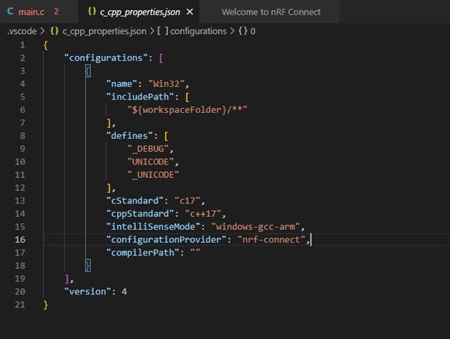

I went through a couple of forum posts,
I followed this post to changed my intellisense mode and then updated the window. But this does not solve the issue. I have attached the screenshort.
I tried reinstalling Visual studio code and Toolchain manager a couple of times. This doesnot help.
What am I missing? I followed automatic installation proceedure using toolchain manager.
