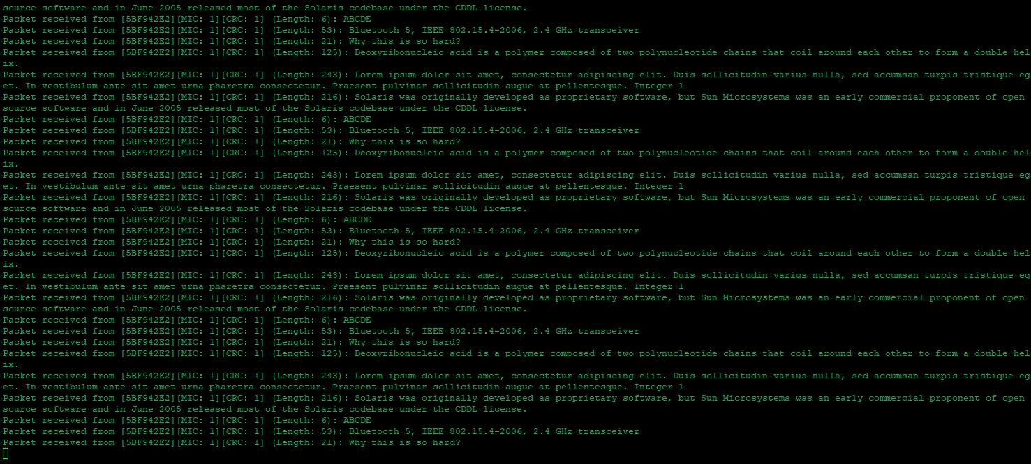

Results vary depending on MAXPACKETSIZE register value.
MAXPACKETSIZE = 240
Packet received from [5BF942E2][MIC: 1][CRC: 1] (Length: 243): Lorem ipsum dolor sit amet, consectetur adipiscing elit. Duis sollicitudin varius nulla, sed accumsan turpis tristique eget. In vestibulum ante sit amet urna pharetra consectetur. Praesent pulvinar sollicitudin augue at pellentesque. I
Packet received from [5BF942E2][MIC: 1][CRC: 1] (Length: 216): Solaris was originally developed as proprietary software, but Sun Microsystems was an early commercial proponent of open source software and in June 2005 released most of the Solaris codebase under the CDDL license.
Packet received from [5BF942E2][MIC: 0][CRC: 1] (Length: 6): ABCDE
Packet received from [5BF942E2][MIC: 0][CRC: 1] (Length: 53): Bluetooth 5, IEEE 802.15.4-2006, 2.4 GHz transceiver
Packet received from [5BF942E2][MIC: 0][CRC: 1] (Length: 21): Why this is so hard?
Packet received from [5BF942E2][MIC: 0][CRC: 1] (Length: 125): Deoxyribonucleic acid is a polymer composed of two polynucleotide chains that coil around each other to form a double helix.
MAXPACKETSIZE = 150
Packet received from [5BF942E2][MIC: 0][CRC: 1] (Length: 243): Lorem ipsum dolor sit amet, consectetur adipiscing elit. Duis sollicitudin varius nulla, sed accumsan turpis tristique eget. In vestibulum ante s
Packet received from [5BF942E2][MIC: 0][CRC: 1] (Length: 216): Solaris was originally developed as proprietary software, but Sun Microsystems was an early commercial proponent of open source software and in J
MAXPACKETSIZE = 50 (all packet has valid MIC, but they are cut to max size)
Packet received from [5BF942E2][MIC: 1][CRC: 1] (Length: 6): ABCDE
Packet received from [5BF942E2][MIC: 1][CRC: 1] (Length: 53): Bluetooth 5, IEEE 802.15.4-2006, 2.4 GHz tran
Packet received from [5BF942E2][MIC: 1][CRC: 1] (Length: 21): Why this is so hard?
Packet received from [5BF942E2][MIC: 1][CRC: 1] (Length: 125): Deoxyribonucleic acid is a polymer composed o
MAXPACKETSIZE = 25 (this is the best, only one packet always has invalid MIC)

What can cause such behavior? How I can get correct MIC status? I will be very grateful for every hint.
