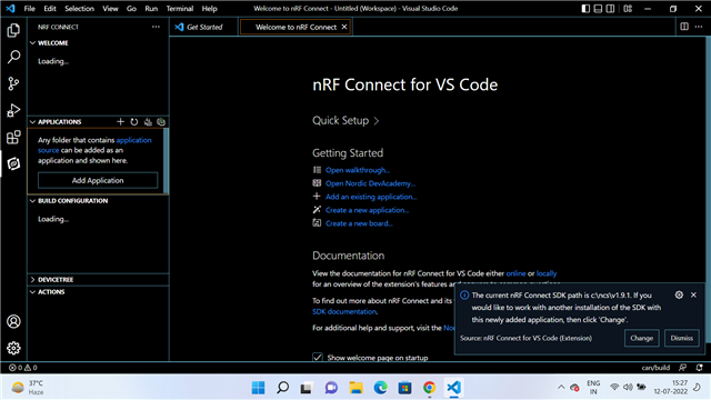

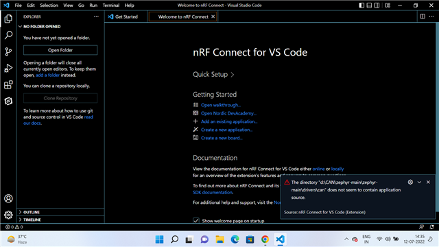

  • Hi, it seems that you tried to build ..ncs/zephyr/samples/drivers/can  or any internal folder in side ../drivers/can/.. ? My query is: after downloading code form above Git link,
    1. Is there any application folder (having src and prj.conf etc) integrated in downloaded code ?
    2.  which folder should be selected in VS to open an existing application ?
    3. I tried to open CAN folder as existing application, but the error appears as in attached image.
    4. download the whole code, see the project structure ? I am not able to find the application folder.
    5. Then I selected samples/ drivers/can folder as existing application and tried to build for default nrf52840 _... board. The error in below image appears
    6. First objective is to build for default Nordic board either for DFRobot or Keysestudio shield. Pls, guide further.
    7. The STATS is defined at points as shown in image below.
    7. The SDK is 1.9.1 as shown in image below. Will it work or need to change ?
    8. The downloaded folder has west (yaml source file), zephyr-env (Windows Command Script) , Zephyr-env (SH Source ), etc files and many folders like .github, arch, boards, cmake, dts, include, kernel, modules, drivers, samples, script etc ... Which west should be configured  and how ?
    9. How you selected dfrobot shield in your build configurations ?
