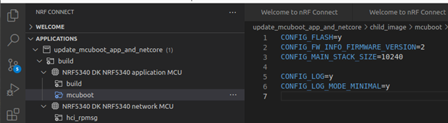

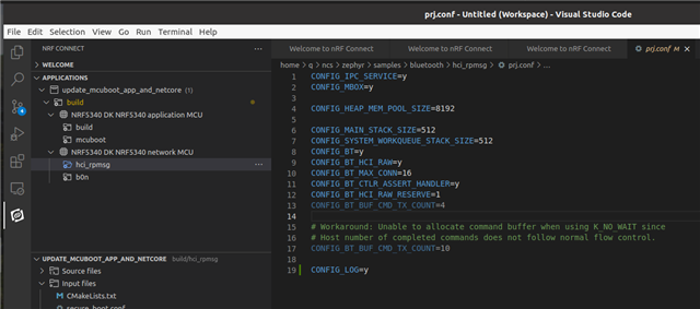

    there are one father image (hello sample) and three child image  (mcuboot hci_rpmsg b0n)
    1. this is father image prj.conf   that include CONFIG_BT and CONFIG_BOOTLOADER_MCUBOOT
    2.  b0n image   , i  already added CONFIG_LOG
    3.hci image  that  added CONFIG_LOG
    4 mcuboot image
    final  let us to see the putty console ,   in the netcore ttyACM0 only shows "boot zephyr (b0n)"   ,not show hci_image log

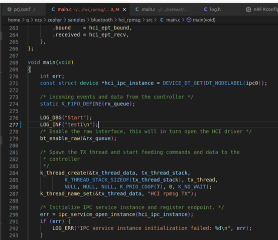

  • 1. my serial console can not display complete  ,  that is my focus
    2. can you output  LOG_INFO  LOG_ERR  LOG_DBG ?   in the title  i tried use CONFIG_LOG_DEFAULT_LEVEL=3 to display LOG_DBG
