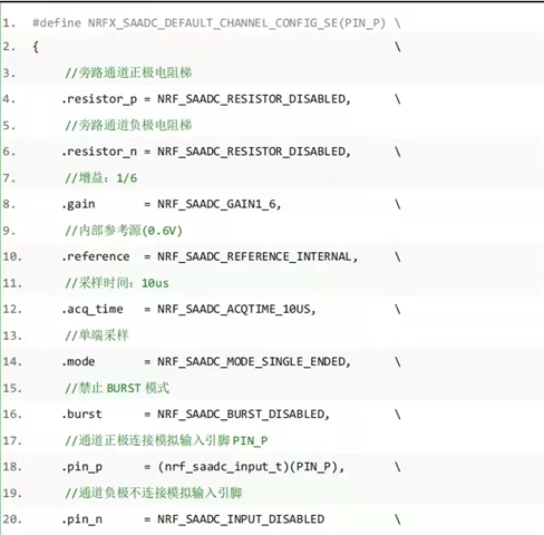

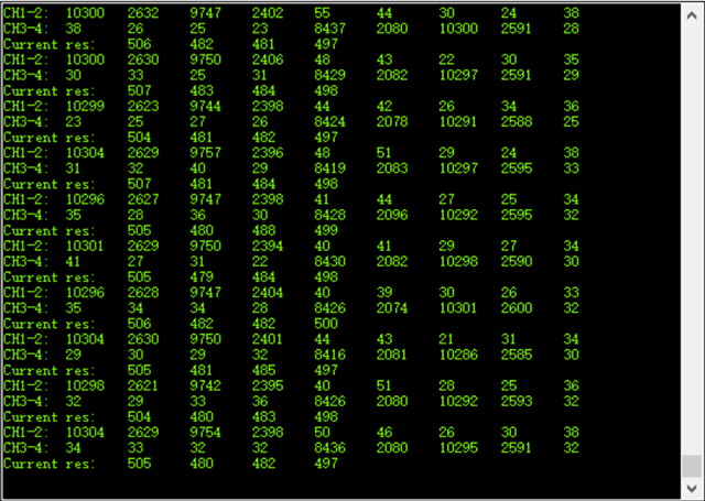

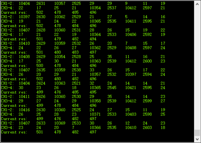

52810 Use 14bit ADC to read parameter from sensor ,the different 52810 that read paramater are different 。it affects the precision of my equipment
this is ADC config

	nrf_saadc_channel_config_t channel_0_config =
        NRF_DRV_SAADC_DEFAULT_CHANNEL_CONFIG_SE(NRF_SAADC_INPUT_AIN0);
    nrf_saadc_channel_config_t channel_1_config =
        NRF_DRV_SAADC_DEFAULT_CHANNEL_CONFIG_SE(NRF_SAADC_INPUT_AIN1);
	nrf_saadc_channel_config_t channel_2_config =
		NRF_DRV_SAADC_DEFAULT_CHANNEL_CONFIG_SE(NRF_SAADC_INPUT_AIN2);
	nrf_saadc_channel_config_t channel_3_config =
		NRF_DRV_SAADC_DEFAULT_CHANNEL_CONFIG_SE(NRF_SAADC_INPUT_AIN3);
	nrf_saadc_channel_config_t channel_4_config =
		NRF_DRV_SAADC_DEFAULT_CHANNEL_CONFIG_SE(NRF_SAADC_INPUT_AIN4);
	nrf_saadc_channel_config_t channel_5_config =
        NRF_DRV_SAADC_DEFAULT_CHANNEL_CONFIG_SE(NRF_SAADC_INPUT_AIN5);
    nrf_saadc_channel_config_t channel_6_config =
        NRF_DRV_SAADC_DEFAULT_CHANNEL_CONFIG_SE(NRF_SAADC_INPUT_AIN6);
	nrf_saadc_channel_config_t channel_7_config =
		NRF_DRV_SAADC_DEFAULT_CHANNEL_CONFIG_SE(NRF_SAADC_INPUT_AIN7);
    err_code = nrf_drv_saadc_init(NULL, Saadc_Callback);
    err_code = nrf_drv_saadc_channel_init(0, &channel_0_config);
    err_code = nrf_drv_saadc_channel_init(1, &channel_1_config);
    err_code = nrf_drv_saadc_channel_init(2, &channel_2_config);
    err_code = nrf_drv_saadc_channel_init(3, &channel_3_config);
    err_code = nrf_drv_saadc_channel_init(4, &channel_4_config);
	err_code = nrf_drv_saadc_channel_init(5, &channel_5_config);
    err_code = nrf_drv_saadc_channel_init(6, &channel_6_config);
    err_code = nrf_drv_saadc_channel_init(7, &channel_7_config);

Q13open,CURR N1和CURR P1 get parameter from temperature sensor 。OUT1 is temperature sensor,it was 0.5Ω resistance
that is different 52810 use the same  temperature sensor !the parameter as follow
10357 9747?
looking for your answer
