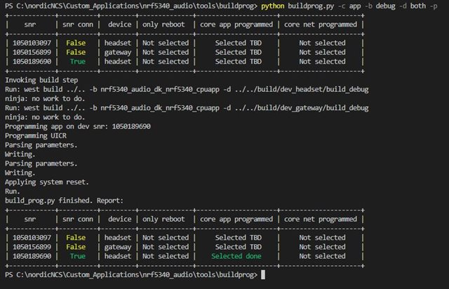

I am using nrf45340 Audio DK to evaluate Bluetooth LE Audio application example.
For experimental purpose, I am using SBC codec. I have been following instructions from the nrf Connect SDK Documentation.
Iam building and programming using script and not command line.
I was able to build the application sucessfully using
python buildprog.py -c app -b debug -d both
After wards, I connected one nrf5340 Audio DK (Headsets right).
After running the python script :
python buildprog.py -c both -b debug -d both -p
I have the following output from the terminal.
As we can see the core net is not programmed. However it was mentioned in the documentation that "Given the -c both parameter, it also takes the precompiled Bluetooth Low Energy Controller binary from the applications/nrf5340_audio/bin directory and programs it to the network core of both the gateway and the headset."
Now the Audio DK lights red in color (Logo - LEDs in the bottom layer.)
I have tried programming all the DKs at once (One gateway and two headsets for stereo). In all the cases I do not see a "selected done" option in "core net programmed" table. After programming the RGB3, LED3, and LED1 does not illuminate.
Edited: Please also note that I was sucessfully able to build and flash the firmware  for each of the DKs "separately" using Command Line.
Am I missing out something? Do we need to explicitly program the network core of the SoC for audio application when using "script"?
