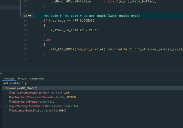

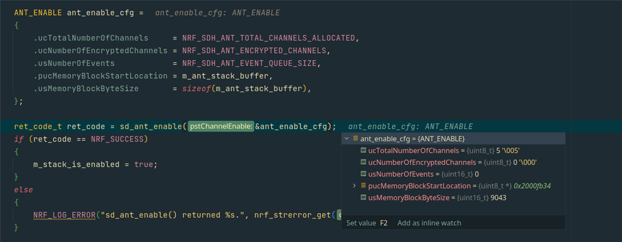

  • I've stepped through the code, and the results are fairly interesting I believe.
    Here's the ant_enable_cfg with NRF_LOG_DEFAULT_LEVEL 0
    And here with NRF_LOG_DEFAULT_LEVEL 5
    They seem basically the same, ignoring some minor differences. What I found wierd was that NRF_LOG_DEFAULT_LEVEL was 3 in both cases according to my debugger, even tho it is clearly set to a different value in the sdk_config.h.
    The even more confusing part however was that the version of the code that is run in the debugger didn't even return an error, but 0, exactly as the version without logs. In other words, it works while debugging, but not while executing without attached debugger. I'm currently checking why that could be, but I haven't found a solution yet.

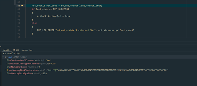

  • I just got a debug run where the error reoccurred by placing a breakpoint only at ANT_ENABLE and nowhere else.
    The ant_enable_cfg values seem very messed up, especially considering that they are set nowhere else than in the sdk_config, where NRF_SDH_ANT_TOTAL_CHANNELS_ALLOCATED is 1, and NRF_SDH_ANT_ENCRYPTED_CHANNELS is 0.
    Those values seem very off indeed, which explains the 0x7 invalid parameter return code. Any idea why this could be happening? Even with the loop from above it doesn't work reliably while logs are disabled. When they are enabled, the values still seem wierd (see below), but are more reasonable, and therefore the program doesn't blow up.
    I find that very confusing, as the values really shouldn't change between runs. You said you believed that to be a memory problem before, and I do agree. How do I find out what exactly the problem is?
