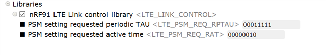

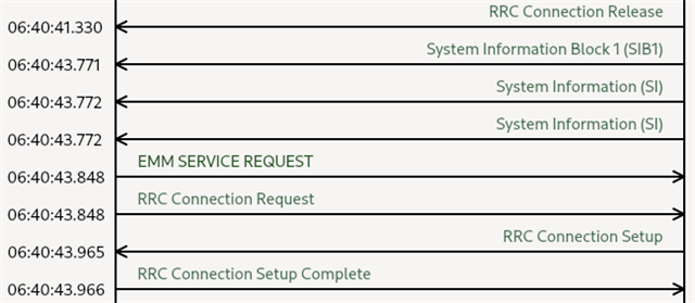

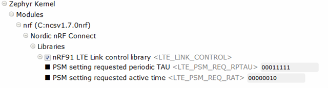

1. If device is in Roaming status then is it will create an issues for GPS fixes?
2. How to check the which operator we are connecting to?
3. Does network operator can create issues for Dev Kits to be in PSM mode? Example: network operator can reject PSM mode settings even if Dev kit asks for 10 mins (TAU) of PSM mode and 1 minute of Active mode (RAT).
