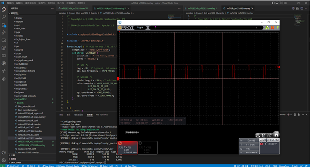

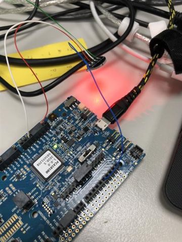

I am using nRf52833-DK with zephry, an now I'm tring to drive ws2812 led strip.
I notice that there is no nRf52833-DK example in zephyr/samples/drivers/led_ws2812/boards.
So I copy y nrf52dk_nrf52832.conf and nrf52dk_nrf52832.overlay to same path , and rename to nrf52833dk_nrf52833.conf and nrf52833dk_nrf52833.overlay.
Here is the example build wilth "west build -b nrf52dk_nrf52832 samples/drivers/led_ws2812/ --pristine", and it work's well.
But if I build with " west build -b nrf52833dk_nrf52833 samples/drivers/led_ws2812/ --pristine", it not working like in video.
Is any way to fix it?

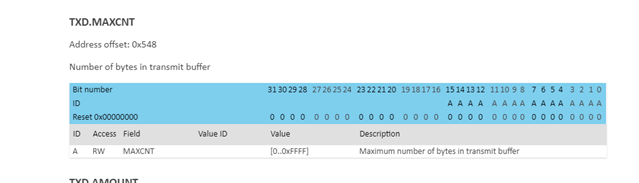

  • I mean I add print chunk to zephyr/drivers/spi/spi_nrfx_spim.c.
    I think 52833 and 52832 chunk should be same size, but not.
    I just wondering it's the problem coming from.

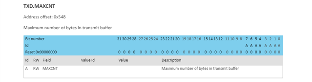

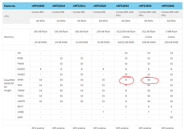

    The nRF52833 supports a longer EasyDMA MAXCNT bit length than the nRF52832. So this is expected.
    nRF52832:
    0b 11111111 -> 255 bytes
    nRF52833:
    0b 1111111111111111 -> 65 535 bytes
    BR,
    Sigurd

    I switch to 52832 temporarily, but I wish I can find the reason why it doesn't work on 52833.
    The singal show on probe really wired.

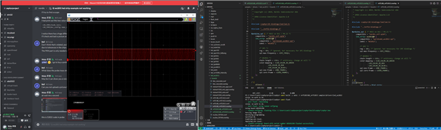

    Looking at the discord thread you linked to, it seems like the conclusion is that it's somehow related to your toolchain/build system setup.
    Maybe you can try to use nRF Connect SDK instead of vanilla zephyr? See this getting started guide:
    http://developer.nordicsemi.com/nRF_Connect_SDK/doc/2.0.2/nrf/gs_assistant.html
