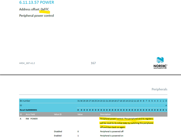

  • thanks for reply Simonor,
    I am calling above suggested piece of code as shown below.
    //Power cycle UART0:
    *(volatile uint32_t *)0x40002FFC = 0;
    nrf_pwr_mgmt_run();
    *(volatile uint32_t *)0x40002FFC;
    *(volatile uint32_t *)0x40002FFC = 1;
    so,it will give power cycle to UART peripheral and in that case ,the peripheral and its registers
    will be reset to its initial state by switching the peripheral off and then back on again. As mentioned in document.
    So, after walkup my UART not working(may be UART remains off), may be because all its settings was cleared at power cycle.
    my question is here, still there something I'm missing in calling sequence or in some settings?
  • Yes, after power cycling the UART you will need to reinitialize the UART again afterwards.
