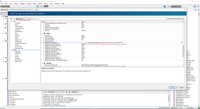

I have an issue on one of my 10056 DK.  The DK is connected to a development PC, appears in device manager as a Jlink CDC UART port, and as a mass storage drive.
When debugging from Segger Embedded Studio, the jlink seems to work (fw downloaded to flash), but the debugging session does not stops neither at the beginning of my main(), neither at breakpoints. CPU registers do not show up any values, as if there is no connection to the target. This happens for any project I'v tried.

    it seems I solved (90%) the issue. All the (example) projects I was using do use a softdevice, which was not loaded (anymore) on the DK. Manually loading the softdevice on the DK apparently solved the issue.
    However (last 10%) I could not still figure out why this has happened, and why in the build/deploy/debug chain of events not even a warning came out.
    Francesco
    Yes, I suspected that this was the root cause. Softdevice examples needs the Softdevice to be flashed for it to start. Usually, our examples are pre-configured so that it flash the Softdevice automatically when you flash with the SES IDE. Check if the Softdevice is listed as additonal load file in the project settings in SES. Note that you have to change the configuration in the upper left corner from release to common:

    I can confirm the Softdevice is (and was) listed as additional load file in the project settings. Also, the project file itself is under version control, so there's no chance for me to inadvertently modify this setting.
    Now (after manually loading the softdevice once) everything works fine, so I guess we can close the ticket up until I find a way to reproduce the situation.
