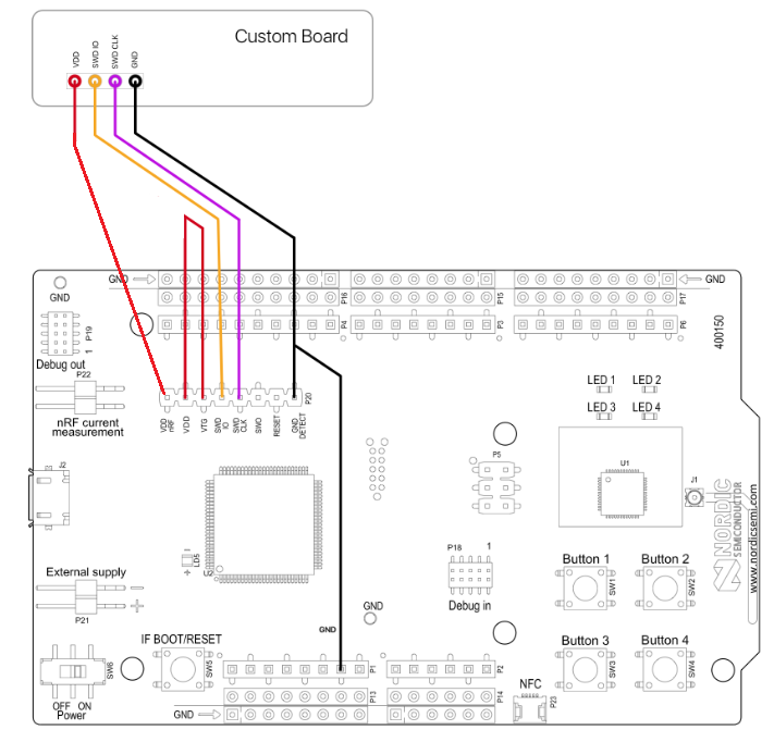

Hi all.  I am fairly new to zephyr so I apologize for any "noob" errors i seem to present.  I have been working with nrf52 dk board and have been able to accomplish many things, pwm, gpio, ble, etc.  However I have decided to switch to a non nordic development board to better understand pin assignment and device tree files, before I design my own custom board.  As I had an arduino 33 ble laying around I decided to solder connections to the swdio swcclk etc connections and connect it to the output from j link debugger on the nrf 52 dk board. I know my connections, and method should be good as I am able to erase and re write the ardunio bootloader to the board though the nrf programmer. To be clear I am trying to not utilize the arduino bootloader and flash directly through nrf connect or through the programmer with the zephyr.hex file. However when I try to flash the board with with the sample nrf blinky blinky program I get no success. The sample program uses pin 9 which I believe should be the green led on the nano 33 ble.

  • yes i had this set up before except with rest attached, however with reset removed it seems to make no difference.  I think really what I am trying to understand is what would be the correct board.cmake, .yaml, and arduino_nano_ble_defconfig file.
    Unless there are any other things that I am missing or could have wrong.  I seem to be able to flash the blinky program to the arduino but it does not do  anything.
