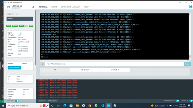

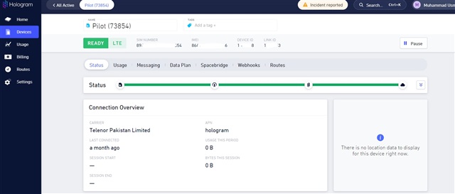

Hi All!
I am using a hologram NB-IoT sim card in nrf9160DK. And want to connect it /send data to nrf cloud. I have activated the sim from the hologram website. When I tried to add the nrf9160Dk in nrf cloud as an LTE device it gives me a 40412 error.LED # 3 is continuously blinking. I read all the related issues but still fail to add the LTE device. The only issue I assume is about the NB-IOT hologram sim. Is it supported by the nrf9160DK modem?. The country I am using this hardware is Pakistan.
Thanks & Regards,
Muhammad Usman

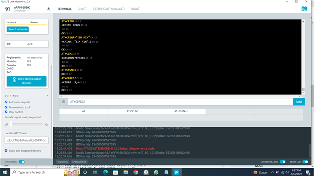

  • Hi Muhammad,
    I assume you have enabled Automatic requests in SETTINGS of LTE Link Monitor.
    Could you run the same commands and then run "AT+CFUN?" at last to trigger the Automatic requests? It should give more information like the following log.

  • Hi Charlie
    Thank you again for the help!
    For automatic request enabled!
    2022-08-16T13:16:57.233Z DEBUG Application data folder: C:\Users\dell\AppData\Roaming\nrfconnect\pc-nrfconnect-linkmonitor
    2022-08-16T13:16:57.388Z INFO Using nrf-device-lib-js version: 0.4.11
    2022-08-16T13:16:57.388Z INFO Using nrf-device-lib version: 0.11.8
    2022-08-16T13:16:57.389Z INFO Using nrfjprog DLL version: 10.15.4
    2022-08-16T13:16:57.389Z INFO Using JLink version: JLink_V7.70
    2022-08-16T13:16:57.439Z DEBUG App pc-nrfconnect-linkmonitor v2.0.1 official
    2022-08-16T13:16:57.439Z DEBUG App path: C:\Users\dell\.nrfconnect-apps\node_modules\pc-nrfconnect-linkmonitor
    2022-08-16T13:16:57.439Z DEBUG nRFConnect 3.11.1, required by the app is (^3.8.0)
    2022-08-16T13:16:57.440Z DEBUG nRFConnect path: C:\Users\dell\AppData\Local\Programs\nrfconnect\resources\app.asar
    2022-08-16T13:16:57.440Z DEBUG HomeDir: C:\Users\dell
    2022-08-16T13:16:57.440Z DEBUG TmpDir: C:\Users\dell\AppData\Local\Temp
    2022-08-16T13:16:57.442Z INFO Installed JLink version does not match the provided version (V7.58b)
    2022-08-16T13:17:03.037Z INFO Modem port is opened
    2022-08-16T13:17:03.063Z DEBUG modem >> AT+CFUN?
    2022-08-16T13:17:03.118Z DEBUG modem << +CFUN: 0
    2022-08-16T13:17:03.126Z DEBUG modem << OK
    2022-08-16T13:17:30.843Z DEBUG modem >> AT+CFUN?
    2022-08-16T13:17:30.859Z DEBUG modem << +CFUN: 0
    2022-08-16T13:17:30.888Z DEBUG modem << OK
    2022-08-16T13:17:34.590Z DEBUG modem >> AT+CGSN=1
    2022-08-16T13:17:34.608Z DEBUG modem << +CGSN: "352656106682498"
    2022-08-16T13:17:34.618Z DEBUG modem << OK
    2022-08-16T13:17:49.084Z DEBUG modem >> AT+CGMI
    2022-08-16T13:17:49.101Z DEBUG modem << Nordic Semiconductor ASA
    2022-08-16T13:17:49.105Z DEBUG modem << OK

    2022-08-16T13:22:47.381Z DEBUG modem >> AT+CPIN?
    2022-08-16T13:22:47.396Z DEBUG modem << ERROR
    2022-08-16T13:22:47.398Z ERROR Error: AT+CPIN?
     failed
    2022-08-16T13:23:21.181Z DEBUG modem >> AT+CPINR="SIM PIN"
    2022-08-16T13:23:21.198Z DEBUG modem << ERROR
    2022-08-16T13:23:21.200Z ERROR Error: AT+CPINR="SIM PIN"
     failed
    2022-08-16T13:23:37.144Z DEBUG modem >> AT+CIMI
    2022-08-16T13:23:37.159Z DEBUG modem << ERROR
    2022-08-16T13:23:37.163Z ERROR Error: AT+CIMI
     failed
    2022-08-16T13:24:24.968Z DEBUG modem >> AT+CFUN=4
    2022-08-16T13:24:24.984Z DEBUG modem << OK
    2022-08-16T13:24:30.441Z DEBUG modem >> AT+CFUN?
    2022-08-16T13:24:30.461Z DEBUG modem << +CFUN: 4
    2022-08-16T13:24:30.474Z DEBUG modem << OK
    2022-08-16T13:24:30.482Z DEBUG modem >> AT+CFUN=1
    2022-08-16T13:24:30.526Z DEBUG modem << OK
    2022-08-16T13:24:31.202Z DEBUG modem << %XSIM: 1
    2022-08-16T13:24:31.242Z DEBUG modem >> AT+CPIN?
    2022-08-16T13:24:31.263Z DEBUG modem << +CPIN: READY
    2022-08-16T13:24:31.267Z DEBUG modem << OK
    2022-08-16T13:24:31.300Z DEBUG modem >> AT+CPINR="SIM PIN"
    2022-08-16T13:24:31.320Z DEBUG modem << +CPINR: "SIM PIN",3
    2022-08-16T13:24:31.324Z DEBUG modem << OK
    2022-08-16T13:24:31.350Z DEBUG modem >> AT+CIMI
    2022-08-16T13:24:31.375Z DEBUG modem << 234500007597385
    2022-08-16T13:24:31.382Z DEBUG modem << OK
    2022-08-16T13:24:31.387Z INFO IMSIdentity: 234500007597385
    2022-08-16T13:24:49.478Z DEBUG modem >> AT%XSYSTEMMODE=0,1,0,0
    2022-08-16T13:24:49.488Z DEBUG modem << ERROR
    2022-08-16T13:24:49.490Z ERROR Error: AT%XSYSTEMMODE=0,1,0,0
     failed
    2022-08-16T13:25:06.017Z DEBUG modem >> AT%XSYSTEMMODE=0,1,0,0
    2022-08-16T13:25:06.031Z DEBUG modem << ERROR
    2022-08-16T13:25:06.035Z ERROR Error: AT%XSYSTEMMODE=0,1,0,0
     failed
    2022-08-16T13:25:09.915Z DEBUG modem >> AT%XSYSTEMMODE=0,1,0,0
    2022-08-16T13:25:09.925Z DEBUG modem << ERROR
    2022-08-16T13:25:09.929Z ERROR Error: AT%XSYSTEMMODE=0,1,0,0
     failed
    2022-08-16T13:25:22.611Z DEBUG modem >> AT+CFUN?

    2022-08-16T13:26:31.240Z DEBUG modem >> AT+CFUN=4
    2022-08-16T13:26:31.261Z DEBUG modem << OK
    2022-08-16T13:26:31.271Z DEBUG modem << +CEREG: 0
    2022-08-16T13:26:31.283Z DEBUG modem << %XSIM: 0
    2022-08-16T13:26:36.532Z DEBUG modem >> AT+CFUN?
    2022-08-16T13:26:36.550Z DEBUG modem << +CFUN: 4
    2022-08-16T13:26:36.567Z DEBUG modem << OK
    2022-08-16T13:26:36.572Z DEBUG modem >> AT+CFUN=1
    2022-08-16T13:26:36.618Z DEBUG modem << OK
    2022-08-16T13:26:37.292Z DEBUG modem << %XSIM: 1
    2022-08-16T13:26:37.342Z DEBUG modem >> AT+CPIN?
    2022-08-16T13:26:37.373Z DEBUG modem << +CPIN: READY
    2022-08-16T13:26:37.385Z DEBUG modem << OK
    2022-08-16T13:26:37.406Z DEBUG modem >> AT+CPINR="SIM PIN"
    2022-08-16T13:26:37.426Z DEBUG modem << +CPINR: "SIM PIN",3
    2022-08-16T13:26:37.428Z DEBUG modem << OK
    2022-08-16T13:26:37.437Z DEBUG modem >> AT+CIMI
    2022-08-16T13:26:37.445Z DEBUG modem << 234500007597385
    2022-08-16T13:26:37.451Z DEBUG modem << OK
    2022-08-16T13:26:37.453Z INFO IMSIdentity: 234500007597385
    2022-08-16T13:26:44.385Z DEBUG modem >> AT%XSYSTEMMODE=0,1,0,0
    2022-08-16T13:26:44.401Z DEBUG modem << +CME ERROR: 518
    2022-08-16T13:26:44.405Z ERROR Error: AT%XSYSTEMMODE=0,1,0,0
     failed: Unknown error code

    2022-08-16T13:26:54.413Z DEBUG modem << OK
    2022-08-16T13:26:54.417Z DEBUG modem >> AT+CGMR
    2022-08-16T13:26:54.426Z DEBUG modem << mfw_nrf9160_1.3.2
    2022-08-16T13:26:54.443Z DEBUG modem << OK
    2022-08-16T13:26:54.446Z INFO Nordic Semiconductor ASA nRF9160-SICA [mfw_nrf9160_1.3.2] SerNr: 352656106682498
    2022-08-16T13:26:54.455Z DEBUG modem >> AT+CEMODE?
    2022-08-16T13:26:54.468Z DEBUG modem << +CEMODE: 2
    2022-08-16T13:26:54.471Z DEBUG modem << OK
    2022-08-16T13:26:54.478Z DEBUG modem >> AT%XCBAND=?
    2022-08-16T13:26:54.489Z DEBUG modem << %XCBAND: (1,2,3,4,5,8,12,13,18,19,20,25,26,28,66)
    2022-08-16T13:26:54.491Z DEBUG modem <<
    2022-08-16T13:26:54.493Z DEBUG modem << OK
    2022-08-16T13:26:54.501Z DEBUG modem >> AT+CMEE?
    2022-08-16T13:26:54.508Z DEBUG modem << +CMEE: 1
    2022-08-16T13:26:54.513Z DEBUG modem << OK
    2022-08-16T13:26:54.517Z DEBUG modem >> AT+CNEC?
    2022-08-16T13:26:54.546Z DEBUG modem << +CNEC: 24
    2022-08-16T13:26:54.550Z DEBUG modem << OK
    2022-08-16T13:26:54.554Z DEBUG modem >> AT+CGEREP?
    2022-08-16T13:26:54.568Z DEBUG modem << +CGEREP: 1,0
    2022-08-16T13:26:54.571Z DEBUG modem << OK
    2022-08-16T13:26:54.575Z DEBUG modem >> AT+CIND=1,1,1
    2022-08-16T13:26:54.583Z DEBUG modem << OK
    2022-08-16T13:26:54.587Z DEBUG modem >> AT+CEREG=5
    2022-08-16T13:26:54.595Z DEBUG modem << OK
    2022-08-16T13:26:54.599Z DEBUG modem >> AT+CEREG?
    2022-08-16T13:26:54.616Z DEBUG modem << +CEREG: 5,0
    2022-08-16T13:26:54.628Z DEBUG modem << OK
    2022-08-16T13:26:54.649Z DEBUG modem >> AT%CESQ=1
    2022-08-16T13:26:54.657Z DEBUG modem << OK
    2022-08-16T13:26:54.669Z DEBUG modem >> AT+CESQ
    2022-08-16T13:26:54.684Z DEBUG modem << +CESQ: 99,99,255,255,255,255
    2022-08-16T13:26:54.686Z DEBUG modem << OK
    2022-08-16T13:26:54.701Z DEBUG modem >> AT%XSIM=1
    2022-08-16T13:26:54.717Z DEBUG modem << OK
    2022-08-16T13:26:54.721Z DEBUG modem >> AT%XSIM?
    2022-08-16T13:26:54.733Z DEBUG modem << %XSIM: 1
    2022-08-16T13:26:54.736Z DEBUG modem <<
    2022-08-16T13:26:54.737Z DEBUG modem << OK
    2022-08-16T13:26:54.753Z DEBUG modem >> AT+CPIN?
    2022-08-16T13:26:54.767Z DEBUG modem << +CPIN: READY
    2022-08-16T13:26:54.769Z DEBUG modem << OK
    2022-08-16T13:26:54.786Z DEBUG modem >> AT+CPINR="SIM PIN"
    2022-08-16T13:26:54.801Z DEBUG modem << +CPINR: "SIM PIN",3
    2022-08-16T13:26:54.803Z DEBUG modem <<
    2022-08-16T13:26:54.805Z DEBUG modem << OK
    2022-08-16T13:26:54.822Z DEBUG modem >> AT+CIMI
    2022-08-16T13:26:54.852Z DEBUG modem << 234500007597385
    2022-08-16T13:26:54.855Z DEBUG modem << OK
    2022-08-16T13:26:54.856Z INFO IMSIdentity: 234500007597385
    2022-08-16T13:27:03.536Z DEBUG modem >> AT+CFUN=1
    2022-08-16T13:27:03.544Z DEBUG modem << OK
    2022-08-16T13:27:12.605Z DEBUG modem >> AT+CEREG?
    2022-08-16T13:27:12.616Z DEBUG modem << +CEREG: 5,0
    2022-08-16T13:27:12.629Z DEBUG modem << OK
    and for the log please find the attachment!
    Thank you Again!
