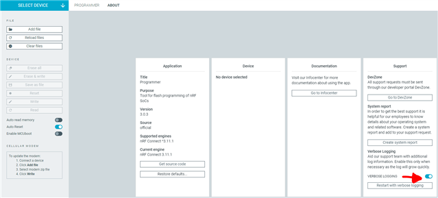

Critical Issue: nRF52-DK, PCA10040 3.0.0 2022.14. Programmer v3.0.3 can not erase and Keil can not identify board and J-LINK Interface.
Dear Nordic support team,
I bought 3 piece of nRF52-DK from MOUSER, 1 piece of nRF52-DK version is 2.1.0 , and another 2 piece version is 3.0.0.
nRF52-DK version 2.1.0, Programmer and Keil test ok.
nRF52 DK, PCA10040 3.0.0 2022.14. Programmer v3.0.3 can not erase and identify board, why?
Keil5 MDK v5.25.2.0, Debug -> Cannot find any J-LINK ??

    Okay, thank you for sharing. From the log, the procedures all seem to finish correctly as there are no errors, and you can see that app protect is enabled as you can see here:

    Next, the reason this is "UNKNOWN" I think is because the Programmer app hasn't been updated to recognize rev. 3.0.0 of the nRF52 DKs. I will contact the developers to confirm this and get back to you with an update.

    Q1. Something is serious error, follow the steps I said,
    step1.Open Programmer v3.0.0.
    step2.switch ON nRF52-DK(PCA10040, v3.0.0)
    step3.Select Device "nRF52 DK" in Programmer.
    step4.Choose "Erase all".
    step5.You will find that Erase ok and No message "Device is protected".
    step6.switch OFF nRF52-DK(PCA10040, v3.0.0), wait 10 seconds.
    step7.switch ON nRF52-DK(PCA10040, v3.0.0).
    step8.Select Device "nRF52 DK" in Programmer.
    step9.See "Device is protected" again, why?  PCA10040 v2.1.0 no error message here.

    Q2. Keil MDK v5.25.2.0 can not identify J-LINK on nRF52-DK(PCA10040, v3.0.0), this is very critical issue. Because I can not load any example code from SDK 15.2.0.

  • Good news,
    I download J-link new software manually from SEGGER website, and Keil 5 identify J-LINK OB now.

  • Hi again
    Just so we can look into this on our side, can you turn on Verbose logging (see image below) and upload the log you see there? I unfortunately don't have a DK v3.0.0 at hand to reproduce this on my end.
