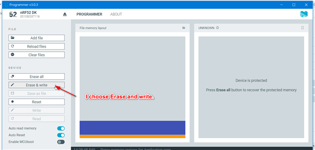

Critical Issue: nRF52-DK, PCA10040 3.0.0 2022.14. Programmer v3.0.3 can not erase and Keil can not identify board and J-LINK Interface.
Dear Nordic support team,
I bought 3 piece of nRF52-DK from MOUSER, 1 piece of nRF52-DK version is 2.1.0 , and another 2 piece version is 3.0.0.
nRF52-DK version 2.1.0, Programmer and Keil test ok.

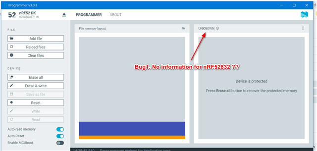

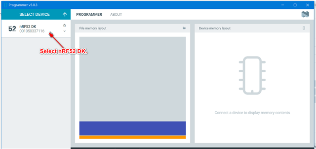

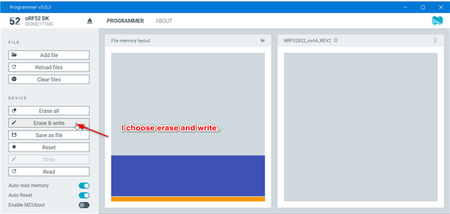

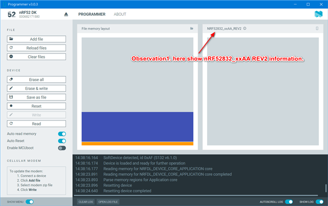

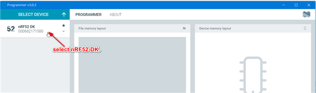

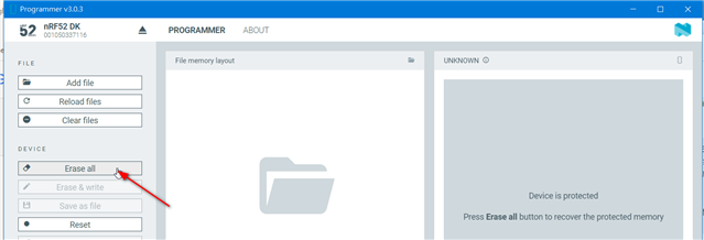

nRF52 DK, PCA10040 3.0.0 2022.14. Programmer v3.0.3 can not erase and identify board, why?
Keil5 MDK v5.25.2.0, Debug -> Cannot find any J-LINK ??
Lishen

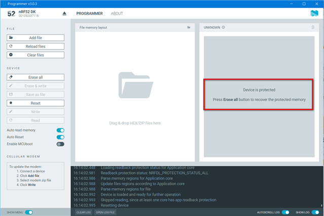

  • Hi
    It has a different APP Protect implementation than the 2.1.0 version. Try doing an Erase All as recommended by the Programmer app, that should let you write new applications onto your Development Kit. If there is some other issue, show me the log of the nRF Connect Programmer app, as you seem to only have provided screenshots of the GUI.
    Simon

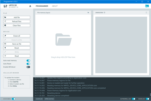

    I show nRF52-DK v2.1.0 picture.  Same operation process, but v2.1.0 test ok.
    Lishen

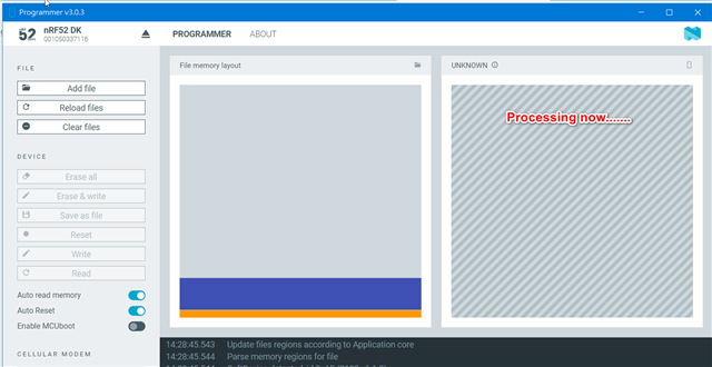

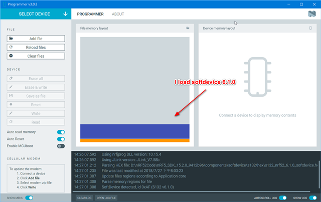

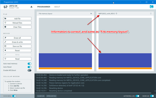

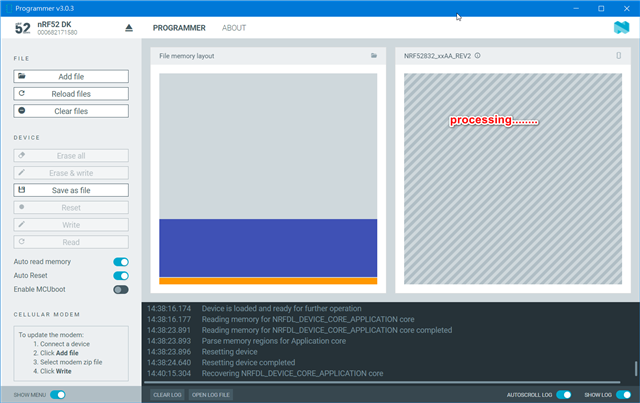

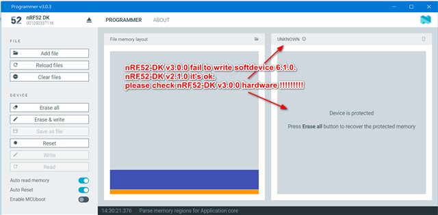

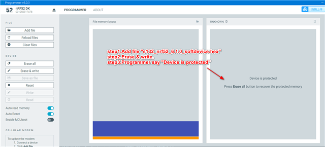

  • Erase all is normal. But I want to add file "s132_nrf52_6.1.0_softdevice.hex" and use "erase and write", result is fail and still show "Device is protected".
    I am very sure nRF52-DK v3.0.0 is very different from v2.1.0.

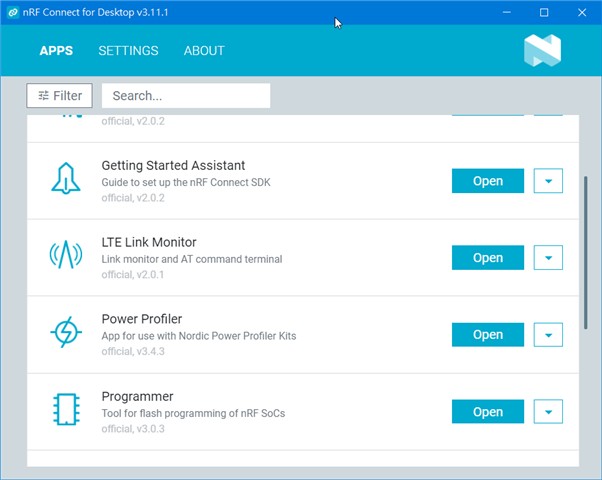

  • 2022-07-18T07:00:58.526Z DEBUG Application data folder: C:\Users\USER\AppData\Roaming\nrfconnect\pc-nrfconnect-programmer
    2022-07-18T07:00:58.586Z INFO Using nrf-device-lib-js version: 0.4.11
    2022-07-18T07:00:58.586Z INFO Using nrf-device-lib version: 0.11.8
    2022-07-18T07:00:58.586Z INFO Using nrfjprog DLL version: 10.15.4
    2022-07-18T07:00:58.586Z INFO Using JLink version: JLink_V7.58b
    2022-07-18T07:00:58.617Z DEBUG App pc-nrfconnect-programmer v3.0.3 official
    2022-07-18T07:00:58.617Z DEBUG App path: C:\Users\USER\.nrfconnect-apps\node_modules\pc-nrfconnect-programmer
    2022-07-18T07:00:58.617Z DEBUG nRFConnect 3.11.1, required by the app is (^3.11.1)

    2022-07-18T07:01:02.214Z INFO Loading readback protection status for Application core
    2022-07-18T07:01:02.728Z INFO Readback protection status: NRFDL_PROTECTION_STATUS_ALL
    2022-07-18T07:01:02.733Z INFO Parse memory regions for Application core
    2022-07-18T07:01:02.735Z INFO Update files regions according to Application core
    2022-07-18T07:01:02.735Z INFO Parse memory regions for file
    2022-07-18T07:01:02.741Z INFO Device is loaded and ready for further operation
    2022-07-18T07:01:02.742Z INFO Skipped reading, since at least one core has app readback protection

    2022-07-18T07:01:51.705Z INFO Parsing HEX file: D:\nRF52Code\nRF5_SDK_15.2.0_9412b96\components\softdevice\s132\hex\s132_nrf52_6.1.0_softdevice.hex
    2022-07-18T07:01:51.716Z INFO File was last modified at 2018/7/27 下午8:03:23
    2022-07-18T07:01:51.776Z INFO Update files regions according to Application core
    2022-07-18T07:01:51.776Z INFO Parse memory regions for file
    2022-07-18T07:01:51.777Z INFO SoftDevice detected, id 0xAF (S132 v6.1.0)
    2022-07-18T07:01:55.305Z INFO Recovering NRFDL_DEVICE_CORE_APPLICATION core
    2022-07-18T07:01:58.909Z INFO Recovering NRFDL_DEVICE_CORE_APPLICATION core completed
    2022-07-18T07:01:58.914Z INFO Device recovery completed
    2022-07-18T07:01:58.914Z INFO Writing procedure starts for NRFDL_DEVICE_CORE_APPLICATION core
    2022-07-18T07:01:58.979Z INFO Writing HEX to NRFDL_DEVICE_CORE_APPLICATION core
    2022-07-18T07:01:59.467Z INFO Uploading image through JLink: 0%
    2022-07-18T07:02:02.443Z INFO Uploading image through JLink: 100%
    2022-07-18T07:02:02.583Z INFO Writing HEX to NRFDL_DEVICE_CORE_APPLICATION core completed
    2022-07-18T07:02:02.584Z INFO Writing procedure ends for NRFDL_DEVICE_CORE_APPLICATION core
    2022-07-18T07:02:02.586Z INFO Resetting device
    2022-07-18T07:02:03.291Z INFO Resetting device completed

    2022-07-18T07:02:03.797Z INFO Parse memory regions for file
    2022-07-18T07:02:03.797Z INFO SoftDevice detected, id 0xAF (S132 v6.1.0)
    2022-07-18T07:02:03.799Z INFO Device is loaded and ready for further operation
    2022-07-18T07:02:03.800Z INFO Skipped reading, since at least one core has app readback protection
    2022-07-18T07:02:03.801Z INFO Resetting device
    2022-07-18T07:02:10.265Z INFO Recovering NRFDL_DEVICE_CORE_APPLICATION core
    2022-07-18T07:02:13.870Z INFO Recovering NRFDL_DEVICE_CORE_APPLICATION core completed
    2022-07-18T07:02:13.874Z INFO Device recovery completed
    2022-07-18T07:02:13.874Z INFO Writing procedure starts for NRFDL_DEVICE_CORE_APPLICATION core
    2022-07-18T07:02:13.942Z INFO Writing HEX to NRFDL_DEVICE_CORE_APPLICATION core
    2022-07-18T07:02:14.442Z INFO Uploading image through JLink: 0%
    2022-07-18T07:02:17.408Z INFO Uploading image through JLink: 100%
    2022-07-18T07:02:17.558Z INFO Writing HEX to NRFDL_DEVICE_CORE_APPLICATION core completed
    2022-07-18T07:02:17.558Z INFO Writing procedure ends for NRFDL_DEVICE_CORE_APPLICATION core
    2022-07-18T07:02:17.560Z INFO Resetting device
    2022-07-18T07:02:18.266Z INFO Resetting device completed
    2022-07-18T07:02:18.268Z INFO Using @nordicsemiconductor/nrf-device-lib-js to communicate with target via JLink
    2022-07-18T07:02:18.268Z INFO JLink OB firmware version J-Link OB-nRF5340-NordicSemi compiled Jul 2 2021 10:55:25
    2022-07-18T07:02:18.268Z DEBUG Sending usage data {"category":"pc-nrfconnect-programmer","action":"Open jlink OB version","label":"J-Link OB-nRF5340-NordicSemi compiled Jul 2 2021 10:55:25"}
    2022-07-18T07:02:18.270Z INFO Device family NRF52
    2022-07-18T07:02:18.270Z DEBUG Sending usage data {"category":"pc-nrfconnect-programmer","action":"Open jlink device family","label":"NRF52"}
    2022-07-18T07:02:18.271Z INFO Device version UNKNOWN
    2022-07-18T07:02:18.272Z DEBUG Sending usage data {"category":"pc-nrfconnect-programmer","action":"Open jlink device version","label":"UNKNOWN"}
    2022-07-18T07:02:18.272Z INFO Board version PCA10040
    2022-07-18T07:02:18.272Z DEBUG Sending usage data {"category":"pc-nrfconnect-programmer","action":"Open jlink device board version","label":"PCA10040"}
    2022-07-18T07:02:18.273Z INFO Loading readback protection status for Application core
    2022-07-18T07:02:18.773Z INFO Readback protection status: NRFDL_PROTECTION_STATUS_ALL
    2022-07-18T07:02:18.775Z INFO Parse memory regions for Application core
    2022-07-18T07:02:18.776Z INFO Update files regions according to Application core
    2022-07-18T07:02:18.776Z INFO Parse memory regions for file
    2022-07-18T07:02:18.776Z INFO SoftDevice detected, id 0xAF (S132 v6.1.0)
    2022-07-18T07:02:18.778Z INFO Device is loaded and ready for further operation
    2022-07-18T07:02:18.779Z INFO Skipped reading, since at least one core has app readback protection
    2022-07-18T07:02:18.780Z INFO Resetting device
    2022-07-18T07:02:22.105Z DEBUG Sending usage data {"category":"pc-nrfconnect-programmer","action":"Close device","label":""}
    2022-07-18T07:02:22.107Z INFO Target device closed
    2022-07-18T07:02:29.728Z INFO Using @nordicsemiconductor/nrf-device-lib-js to communicate with target via JLink
    2022-07-18T07:02:29.728Z INFO JLink OB firmware version J-Link OB-nRF5340-NordicSemi compiled Jul 2 2021 10:55:25
    2022-07-18T07:02:29.728Z DEBUG Sending usage data {"category":"pc-nrfconnect-programmer","action":"Open jlink OB version","label":"J-Link OB-nRF5340-NordicSemi compiled Jul 2 2021 10:55:25"}
    2022-07-18T07:02:29.730Z INFO Device family NRF52
    2022-07-18T07:02:29.730Z DEBUG Sending usage data {"category":"pc-nrfconnect-programmer","action":"Open jlink device family","label":"NRF52"}
    2022-07-18T07:02:29.731Z INFO Device version UNKNOWN
    2022-07-18T07:02:29.732Z DEBUG Sending usage data {"category":"pc-nrfconnect-programmer","action":"Open jlink device version","label":"UNKNOWN"}
    2022-07-18T07:02:29.732Z INFO Board version PCA10040
    2022-07-18T07:02:29.732Z DEBUG Sending usage data {"category":"pc-nrfconnect-programmer","action":"Open jlink device board version","label":"PCA10040"}
    2022-07-18T07:02:29.733Z INFO Loading readback protection status for Application core
    2022-07-18T07:02:29.734Z DEBUG Sending usage data {"category":"pc-nrfconnect-programmer","action":"Open device","label":"jlink"}
    2022-07-18T07:02:30.243Z INFO Readback protection status: NRFDL_PROTECTION_STATUS_ALL
    2022-07-18T07:02:30.246Z INFO Parse memory regions for Application core
    2022-07-18T07:02:30.246Z INFO Update files regions according to Application core
    2022-07-18T07:02:30.246Z INFO Parse memory regions for file
    2022-07-18T07:02:30.247Z INFO SoftDevice detected, id 0xAF (S132 v6.1.0)
    2022-07-18T07:02:30.250Z INFO Device is loaded and ready for further operation
    2022-07-18T07:02:30.251Z INFO Skipped reading, since at least one core has app readback protection
    2022-07-18T07:02:30.253Z INFO Resetting device
    2022-07-18T07:02:33.385Z DEBUG Sending usage data {"category":"pc-nrfconnect-programmer","action":"Close device","label":""}
    2022-07-18T07:02:33.386Z INFO Target device closed
    2022-07-18T07:02:37.208Z INFO Using @nordicsemiconductor/nrf-device-lib-js to communicate with target via JLink
    2022-07-18T07:02:37.208Z INFO JLink OB firmware version J-Link OB-nRF5340-NordicSemi compiled Jul 2 2021 10:55:25
    2022-07-18T07:02:37.208Z DEBUG Sending usage data {"category":"pc-nrfconnect-programmer","action":"Open jlink OB version","label":"J-Link OB-nRF5340-NordicSemi compiled Jul 2 2021 10:55:25"}
    2022-07-18T07:02:37.210Z INFO Device family NRF52
    2022-07-18T07:02:37.210Z DEBUG Sending usage data {"category":"pc-nrfconnect-programmer","action":"Open jlink device family","label":"NRF52"}
    2022-07-18T07:02:37.211Z INFO Device version UNKNOWN
    2022-07-18T07:02:37.211Z DEBUG Sending usage data {"category":"pc-nrfconnect-programmer","action":"Open jlink device version","label":"UNKNOWN"}
    2022-07-18T07:02:37.212Z INFO Board version PCA10040
    2022-07-18T07:02:37.212Z DEBUG Sending usage data {"category":"pc-nrfconnect-programmer","action":"Open jlink device board version","label":"PCA10040"}
    2022-07-18T07:02:37.213Z INFO Loading readback protection status for Application core
    2022-07-18T07:02:37.213Z DEBUG Sending usage data {"category":"pc-nrfconnect-programmer","action":"Open device","label":"jlink"}
    2022-07-18T07:02:37.748Z INFO Readback protection status: NRFDL_PROTECTION_STATUS_ALL
    2022-07-18T07:02:37.752Z INFO Parse memory regions for Application core
    2022-07-18T07:02:37.754Z INFO Update files regions according to Application core
    2022-07-18T07:02:37.754Z INFO Parse memory regions for file
    2022-07-18T07:02:37.754Z INFO SoftDevice detected, id 0xAF (S132 v6.1.0)
    2022-07-18T07:02:37.758Z INFO Device is loaded and ready for further operation
    2022-07-18T07:02:37.761Z INFO Skipped reading, since at least one core has app readback protection
    2022-07-18T07:02:37.763Z INFO Resetting device
    2022-07-18T07:02:41.257Z DEBUG Sending usage data {"category":"pc-nrfconnect-programmer","action":"Close device","label":""}
    2022-07-18T07:02:41.258Z INFO Target device closed
    2022-07-18T07:02:44.086Z INFO Using @nordicsemiconductor/nrf-device-lib-js to communicate with target via JLink
    2022-07-18T07:02:44.086Z INFO JLink OB firmware version J-Link OB-nRF5340-NordicSemi compiled Jul 2 2021 10:55:25
    2022-07-18T07:02:44.086Z DEBUG Sending usage data {"category":"pc-nrfconnect-programmer","action":"Open jlink OB version","label":"J-Link OB-nRF5340-NordicSemi compiled Jul 2 2021 10:55:25"}
    2022-07-18T07:02:44.087Z INFO Device family NRF52
    2022-07-18T07:02:44.088Z DEBUG Sending usage data {"category":"pc-nrfconnect-programmer","action":"Open jlink device family","label":"NRF52"}
    2022-07-18T07:02:44.088Z INFO Device version UNKNOWN
    2022-07-18T07:02:44.089Z DEBUG Sending usage data {"category":"pc-nrfconnect-programmer","action":"Open jlink device version","label":"UNKNOWN"}
    2022-07-18T07:02:44.090Z INFO Board version PCA10040
    2022-07-18T07:02:44.090Z DEBUG Sending usage data {"category":"pc-nrfconnect-programmer","action":"Open jlink device board version","label":"PCA10040"}
    2022-07-18T07:02:44.091Z INFO Loading readback protection status for Application core
    2022-07-18T07:02:44.091Z DEBUG Sending usage data {"category":"pc-nrfconnect-programmer","action":"Open device","label":"jlink"}
    2022-07-18T07:02:44.608Z INFO Readback protection status: NRFDL_PROTECTION_STATUS_ALL
    2022-07-18T07:02:44.612Z INFO Parse memory regions for Application core
    2022-07-18T07:02:44.613Z INFO Update files regions according to Application core
    2022-07-18T07:02:44.613Z INFO Parse memory regions for file
    2022-07-18T07:02:44.613Z INFO SoftDevice detected, id 0xAF (S132 v6.1.0)
    2022-07-18T07:02:44.615Z INFO Device is loaded and ready for further operation
    2022-07-18T07:02:44.616Z INFO Skipped reading, since at least one core has app readback protection
    2022-07-18T07:02:44.618Z INFO Resetting device
    2022-07-18T07:02:49.176Z INFO Recovering NRFDL_DEVICE_CORE_APPLICATION core
    2022-07-18T07:02:52.807Z INFO Recovering NRFDL_DEVICE_CORE_APPLICATION core completed
    2022-07-18T07:02:52.809Z INFO Device recovery completed
    2022-07-18T07:02:52.809Z INFO Writing procedure starts for NRFDL_DEVICE_CORE_APPLICATION core
    2022-07-18T07:02:52.879Z INFO Writing HEX to NRFDL_DEVICE_CORE_APPLICATION core
    2022-07-18T07:02:53.400Z INFO Uploading image through JLink: 0%
    2022-07-18T07:02:56.372Z INFO Uploading image through JLink: 100%
    2022-07-18T07:02:56.533Z INFO Writing HEX to NRFDL_DEVICE_CORE_APPLICATION core completed
    2022-07-18T07:02:56.534Z INFO Writing procedure ends for NRFDL_DEVICE_CORE_APPLICATION core
    2022-07-18T07:02:56.535Z INFO Resetting device
    2022-07-18T07:02:57.243Z INFO Resetting device completed
    2022-07-18T07:02:57.245Z INFO Using @nordicsemiconductor/nrf-device-lib-js to communicate with target via JLink
    2022-07-18T07:02:57.246Z INFO JLink OB firmware version J-Link OB-nRF5340-NordicSemi compiled Jul 2 2021 10:55:25
    2022-07-18T07:02:57.246Z DEBUG Sending usage data {"category":"pc-nrfconnect-programmer","action":"Open jlink OB version","label":"J-Link OB-nRF5340-NordicSemi compiled Jul 2 2021 10:55:25"}
    2022-07-18T07:02:57.247Z INFO Device family NRF52
    2022-07-18T07:02:57.247Z DEBUG Sending usage data {"category":"pc-nrfconnect-programmer","action":"Open jlink device family","label":"NRF52"}
    2022-07-18T07:02:57.248Z INFO Device version UNKNOWN
    2022-07-18T07:02:57.248Z DEBUG Sending usage data {"category":"pc-nrfconnect-programmer","action":"Open jlink device version","label":"UNKNOWN"}
    2022-07-18T07:02:57.249Z INFO Board version PCA10040
    2022-07-18T07:02:57.249Z DEBUG Sending usage data {"category":"pc-nrfconnect-programmer","action":"Open jlink device board version","label":"PCA10040"}
    2022-07-18T07:02:57.250Z INFO Loading readback protection status for Application core
    2022-07-18T07:02:57.752Z INFO Readback protection status: NRFDL_PROTECTION_STATUS_ALL
    2022-07-18T07:02:57.756Z INFO Parse memory regions for Application core
    2022-07-18T07:02:57.759Z INFO Update files regions according to Application core
    2022-07-18T07:02:57.759Z INFO Parse memory regions for file
    2022-07-18T07:02:57.759Z INFO SoftDevice detected, id 0xAF (S132 v6.1.0)
    2022-07-18T07:02:57.763Z INFO Device is loaded and ready for further operation
    2022-07-18T07:02:57.764Z INFO Skipped reading, since at least one core has app readback protection
    2022-07-18T07:02:57.765Z INFO Resetting device
    2022-07-18T07:03:12.640Z INFO Resetting device
    2022-07-18T07:03:14.808Z INFO Resetting device
    2022-07-18T07:03:17.417Z INFO Recovering NRFDL_DEVICE_CORE_APPLICATION core
    2022-07-18T07:03:20.986Z INFO Recovering NRFDL_DEVICE_CORE_APPLICATION core completed
    2022-07-18T07:03:20.988Z INFO Device recovery completed
    2022-07-18T07:03:20.989Z INFO Using @nordicsemiconductor/nrf-device-lib-js to communicate with target via JLink
    2022-07-18T07:03:20.989Z INFO JLink OB firmware version J-Link OB-nRF5340-NordicSemi compiled Jul 2 2021 10:55:25
    2022-07-18T07:03:20.990Z DEBUG Sending usage data {"category":"pc-nrfconnect-programmer","action":"Open jlink OB version","label":"J-Link OB-nRF5340-NordicSemi compiled Jul 2 2021 10:55:25"}
    2022-07-18T07:03:20.991Z INFO Device family NRF52
    2022-07-18T07:03:20.991Z DEBUG Sending usage data {"category":"pc-nrfconnect-programmer","action":"Open jlink device family","label":"NRF52"}
    2022-07-18T07:03:20.993Z INFO Device version UNKNOWN
    2022-07-18T07:03:20.993Z DEBUG Sending usage data {"category":"pc-nrfconnect-programmer","action":"Open jlink device version","label":"UNKNOWN"}
    2022-07-18T07:03:20.995Z INFO Board version PCA10040
    2022-07-18T07:03:20.995Z DEBUG Sending usage data {"category":"pc-nrfconnect-programmer","action":"Open jlink device board version","label":"PCA10040"}
    2022-07-18T07:03:20.996Z INFO Loading readback protection status for Application core
    2022-07-18T07:03:21.660Z INFO Readback protection status: NRFDL_PROTECTION_STATUS_NONE
    2022-07-18T07:03:22.297Z INFO Parse memory regions for Application core
    2022-07-18T07:03:22.298Z INFO Update files regions according to Application core
    2022-07-18T07:03:22.298Z INFO Parse memory regions for file
    2022-07-18T07:03:22.298Z INFO SoftDevice detected, id 0xAF (S132 v6.1.0)
    2022-07-18T07:03:22.300Z INFO Device is loaded and ready for further operation
    2022-07-18T07:03:22.305Z INFO Reading memory for NRFDL_DEVICE_CORE_APPLICATION core
    2022-07-18T07:03:27.114Z INFO Reading memory for NRFDL_DEVICE_CORE_APPLICATION core completed
    2022-07-18T07:03:27.116Z INFO Parse memory regions for Application core
    2022-07-18T07:03:27.118Z INFO Resetting device
    2022-07-18T07:03:27.835Z INFO Resetting device completed
    2022-07-18T07:03:35.921Z INFO Reading memory for NRFDL_DEVICE_CORE_APPLICATION core
    2022-07-18T07:03:40.731Z INFO Reading memory for NRFDL_DEVICE_CORE_APPLICATION core completed
    2022-07-18T07:03:40.732Z INFO Parse memory regions for Application core
    2022-07-18T07:03:40.733Z INFO Resetting device
    2022-07-18T07:03:41.461Z INFO Resetting device completed
    2022-07-18T07:03:48.417Z DEBUG Sending usage data {"category":"pc-nrfconnect-programmer","action":"Close device","label":""}
    2022-07-18T07:03:48.419Z INFO Target device closed
    2022-07-18T07:03:50.045Z INFO Using @nordicsemiconductor/nrf-device-lib-js to communicate with target via JLink
    2022-07-18T07:03:50.045Z INFO JLink OB firmware version J-Link OB-nRF5340-NordicSemi compiled Jul 2 2021 10:55:25
    2022-07-18T07:03:50.045Z DEBUG Sending usage data {"category":"pc-nrfconnect-programmer","action":"Open jlink OB version","label":"J-Link OB-nRF5340-NordicSemi compiled Jul 2 2021 10:55:25"}
    2022-07-18T07:03:50.046Z INFO Device family NRF52
    2022-07-18T07:03:50.047Z DEBUG Sending usage data {"category":"pc-nrfconnect-programmer","action":"Open jlink device family","label":"NRF52"}
    2022-07-18T07:03:50.048Z INFO Device version UNKNOWN
    2022-07-18T07:03:50.048Z DEBUG Sending usage data {"category":"pc-nrfconnect-programmer","action":"Open jlink device version","label":"UNKNOWN"}
    2022-07-18T07:03:50.050Z INFO Board version PCA10040
    2022-07-18T07:03:50.050Z DEBUG Sending usage data {"category":"pc-nrfconnect-programmer","action":"Open jlink device board version","label":"PCA10040"}
    2022-07-18T07:03:50.051Z INFO Loading readback protection status for Application core
    2022-07-18T07:03:50.051Z DEBUG Sending usage data {"category":"pc-nrfconnect-programmer","action":"Open device","label":"jlink"}
    2022-07-18T07:03:50.747Z INFO Readback protection status: NRFDL_PROTECTION_STATUS_NONE
    2022-07-18T07:03:51.398Z INFO Parse memory regions for Application core
    2022-07-18T07:03:51.399Z INFO Update files regions according to Application core
    2022-07-18T07:03:51.399Z INFO Parse memory regions for file
    2022-07-18T07:03:51.399Z INFO SoftDevice detected, id 0xAF (S132 v6.1.0)
    2022-07-18T07:03:51.402Z INFO Device is loaded and ready for further operation
    2022-07-18T07:03:51.403Z INFO Reading memory for NRFDL_DEVICE_CORE_APPLICATION core
    2022-07-18T07:03:56.197Z INFO Reading memory for NRFDL_DEVICE_CORE_APPLICATION core completed
    2022-07-18T07:03:56.198Z INFO Parse memory regions for Application core
    2022-07-18T07:03:56.200Z INFO Resetting device
    2022-07-18T07:03:56.906Z INFO Resetting device completed
    2022-07-18T07:03:58.945Z INFO Reading memory for NRFDL_DEVICE_CORE_APPLICATION core
    2022-07-18T07:04:03.740Z INFO Reading memory for NRFDL_DEVICE_CORE_APPLICATION core completed
    2022-07-18T07:04:03.740Z INFO Parse memory regions for Application core
    2022-07-18T07:04:03.742Z INFO Resetting device
    2022-07-18T07:04:04.464Z INFO Resetting device completed
    2022-07-18T07:04:06.305Z INFO Recovering NRFDL_DEVICE_CORE_APPLICATION core
    2022-07-18T07:04:09.863Z INFO Recovering NRFDL_DEVICE_CORE_APPLICATION core completed
    2022-07-18T07:04:09.865Z INFO Device recovery completed
    2022-07-18T07:04:09.865Z INFO Writing procedure starts for NRFDL_DEVICE_CORE_APPLICATION core
    2022-07-18T07:04:09.928Z INFO Writing HEX to NRFDL_DEVICE_CORE_APPLICATION core
    2022-07-18T07:04:10.421Z INFO Uploading image through JLink: 0%
    2022-07-18T07:04:13.388Z INFO Uploading image through JLink: 100%
    2022-07-18T07:04:13.535Z INFO Writing HEX to NRFDL_DEVICE_CORE_APPLICATION core completed
    2022-07-18T07:04:13.536Z INFO Writing procedure ends for NRFDL_DEVICE_CORE_APPLICATION core
    2022-07-18T07:04:13.538Z INFO Resetting device
    2022-07-18T07:04:14.247Z INFO Resetting device completed
    2022-07-18T07:04:14.249Z INFO Using @nordicsemiconductor/nrf-device-lib-js to communicate with target via JLink
    2022-07-18T07:04:14.249Z INFO JLink OB firmware version J-Link OB-nRF5340-NordicSemi compiled Jul 2 2021 10:55:25
    2022-07-18T07:04:14.249Z DEBUG Sending usage data {"category":"pc-nrfconnect-programmer","action":"Open jlink OB version","label":"J-Link OB-nRF5340-NordicSemi compiled Jul 2 2021 10:55:25"}
    2022-07-18T07:04:14.252Z INFO Device family NRF52
    2022-07-18T07:04:14.252Z DEBUG Sending usage data {"category":"pc-nrfconnect-programmer","action":"Open jlink device family","label":"NRF52"}
    2022-07-18T07:04:14.253Z INFO Device version UNKNOWN
    2022-07-18T07:04:14.253Z DEBUG Sending usage data {"category":"pc-nrfconnect-programmer","action":"Open jlink device version","label":"UNKNOWN"}
    2022-07-18T07:04:14.254Z INFO Board version PCA10040
    2022-07-18T07:04:14.254Z DEBUG Sending usage data {"category":"pc-nrfconnect-programmer","action":"Open jlink device board version","label":"PCA10040"}
    2022-07-18T07:04:14.255Z INFO Loading readback protection status for Application core
    2022-07-18T07:04:14.745Z INFO Readback protection status: NRFDL_PROTECTION_STATUS_ALL
    2022-07-18T07:04:14.749Z INFO Parse memory regions for Application core
    2022-07-18T07:04:14.749Z INFO Update files regions according to Application core
    2022-07-18T07:04:14.750Z INFO Parse memory regions for file
    2022-07-18T07:04:14.750Z INFO SoftDevice detected, id 0xAF (S132 v6.1.0)
    2022-07-18T07:04:14.753Z INFO Device is loaded and ready for further operation
    2022-07-18T07:04:14.753Z INFO Skipped reading, since at least one core has app readback protection
    2022-07-18T07:04:14.754Z INFO Resetting device
    2022-07-18T07:04:20.009Z INFO Recovering NRFDL_DEVICE_CORE_APPLICATION core
    2022-07-18T07:04:23.576Z INFO Recovering NRFDL_DEVICE_CORE_APPLICATION core completed
    2022-07-18T07:04:23.577Z INFO Device recovery completed
    2022-07-18T07:04:23.580Z INFO Using @nordicsemiconductor/nrf-device-lib-js to communicate with target via JLink
    2022-07-18T07:04:23.580Z INFO JLink OB firmware version J-Link OB-nRF5340-NordicSemi compiled Jul 2 2021 10:55:25
    2022-07-18T07:04:23.581Z DEBUG Sending usage data {"category":"pc-nrfconnect-programmer","action":"Open jlink OB version","label":"J-Link OB-nRF5340-NordicSemi compiled Jul 2 2021 10:55:25"}
    2022-07-18T07:04:23.582Z INFO Device family NRF52
    2022-07-18T07:04:23.582Z DEBUG Sending usage data {"category":"pc-nrfconnect-programmer","action":"Open jlink device family","label":"NRF52"}
    2022-07-18T07:04:23.583Z INFO Device version UNKNOWN
    2022-07-18T07:04:23.583Z DEBUG Sending usage data {"category":"pc-nrfconnect-programmer","action":"Open jlink device version","label":"UNKNOWN"}
    2022-07-18T07:04:23.583Z INFO Board version PCA10040
    2022-07-18T07:04:23.584Z DEBUG Sending usage data {"category":"pc-nrfconnect-programmer","action":"Open jlink device board version","label":"PCA10040"}
    2022-07-18T07:04:23.584Z INFO Loading readback protection status for Application core
    2022-07-18T07:04:24.213Z INFO Readback protection status: NRFDL_PROTECTION_STATUS_NONE
    2022-07-18T07:04:24.849Z INFO Parse memory regions for Application core
    2022-07-18T07:04:24.849Z INFO Update files regions according to Application core
    2022-07-18T07:04:24.849Z INFO Parse memory regions for file
    2022-07-18T07:04:24.849Z INFO SoftDevice detected, id 0xAF (S132 v6.1.0)
    2022-07-18T07:04:24.852Z INFO Device is loaded and ready for further operation
    2022-07-18T07:04:24.854Z INFO Reading memory for NRFDL_DEVICE_CORE_APPLICATION core
    2022-07-18T07:04:29.632Z INFO Reading memory for NRFDL_DEVICE_CORE_APPLICATION core completed
    2022-07-18T07:04:29.633Z INFO Parse memory regions for Application core
    2022-07-18T07:04:29.636Z INFO Resetting device
    2022-07-18T07:04:30.347Z INFO Resetting device completed
    2022-07-18T07:04:31.650Z DEBUG Sending usage data {"category":"pc-nrfconnect-programmer","action":"Close device","label":""}
    2022-07-18T07:04:31.651Z INFO Target device closed
    2022-07-18T07:04:33.278Z INFO Using @nordicsemiconductor/nrf-device-lib-js to communicate with target via JLink
    2022-07-18T07:04:33.278Z INFO JLink OB firmware version J-Link OB-nRF5340-NordicSemi compiled Jul 2 2021 10:55:25
    2022-07-18T07:04:33.279Z DEBUG Sending usage data {"category":"pc-nrfconnect-programmer","action":"Open jlink OB version","label":"J-Link OB-nRF5340-NordicSemi compiled Jul 2 2021 10:55:25"}
    2022-07-18T07:04:33.280Z INFO Device family NRF52
    2022-07-18T07:04:33.280Z DEBUG Sending usage data {"category":"pc-nrfconnect-programmer","action":"Open jlink device family","label":"NRF52"}
    2022-07-18T07:04:33.280Z INFO Device version UNKNOWN
    2022-07-18T07:04:33.281Z DEBUG Sending usage data {"category":"pc-nrfconnect-programmer","action":"Open jlink device version","label":"UNKNOWN"}
    2022-07-18T07:04:33.281Z INFO Board version PCA10040
    2022-07-18T07:04:33.281Z DEBUG Sending usage data {"category":"pc-nrfconnect-programmer","action":"Open jlink device board version","label":"PCA10040"}
    2022-07-18T07:04:33.282Z INFO Loading readback protection status for Application core
    2022-07-18T07:04:33.282Z DEBUG Sending usage data {"category":"pc-nrfconnect-programmer","action":"Open device","label":"jlink"}
    2022-07-18T07:04:33.928Z INFO Readback protection status: NRFDL_PROTECTION_STATUS_NONE
    2022-07-18T07:04:34.576Z INFO Parse memory regions for Application core
    2022-07-18T07:04:34.576Z INFO Update files regions according to Application core
    2022-07-18T07:04:34.576Z INFO Parse memory regions for file
    2022-07-18T07:04:34.576Z INFO SoftDevice detected, id 0xAF (S132 v6.1.0)
    2022-07-18T07:04:34.579Z INFO Device is loaded and ready for further operation
    2022-07-18T07:04:34.580Z INFO Reading memory for NRFDL_DEVICE_CORE_APPLICATION core
    2022-07-18T07:04:39.382Z INFO Reading memory for NRFDL_DEVICE_CORE_APPLICATION core completed
    2022-07-18T07:04:39.383Z INFO Parse memory regions for Application core
    2022-07-18T07:04:39.384Z INFO Resetting device
    2022-07-18T07:04:40.109Z INFO Resetting device completed
    2022-07-18T07:04:44.338Z DEBUG Sending usage data {"category":"pc-nrfconnect-programmer","action":"Close device","label":""}
    2022-07-18T07:04:44.340Z INFO Target device closed
    2022-07-18T07:06:25.582Z INFO Using @nordicsemiconductor/nrf-device-lib-js to communicate with target via JLink
    2022-07-18T07:06:25.582Z INFO JLink OB firmware version J-Link OB-nRF5340-NordicSemi compiled Jul 2 2021 10:55:25
    2022-07-18T07:06:25.582Z DEBUG Sending usage data {"category":"pc-nrfconnect-programmer","action":"Open jlink OB version","label":"J-Link OB-nRF5340-NordicSemi compiled Jul 2 2021 10:55:25"}
    2022-07-18T07:06:25.583Z INFO Device family NRF52
    2022-07-18T07:06:25.584Z DEBUG Sending usage data {"category":"pc-nrfconnect-programmer","action":"Open jlink device family","label":"NRF52"}
    2022-07-18T07:06:25.584Z INFO Device version UNKNOWN
    2022-07-18T07:06:25.584Z DEBUG Sending usage data {"category":"pc-nrfconnect-programmer","action":"Open jlink device version","label":"UNKNOWN"}
    2022-07-18T07:06:25.585Z INFO Board version PCA10040
    2022-07-18T07:06:25.585Z DEBUG Sending usage data {"category":"pc-nrfconnect-programmer","action":"Open jlink device board version","label":"PCA10040"}
    2022-07-18T07:06:25.586Z INFO Loading readback protection status for Application core
    2022-07-18T07:06:25.586Z DEBUG Sending usage data {"category":"pc-nrfconnect-programmer","action":"Open device","label":"jlink"}
    2022-07-18T07:06:26.298Z INFO Readback protection status: NRFDL_PROTECTION_STATUS_NONE
    2022-07-18T07:06:26.950Z INFO Parse memory regions for Application core
    2022-07-18T07:06:26.950Z INFO Update files regions according to Application core
    2022-07-18T07:06:26.950Z INFO Parse memory regions for file
    2022-07-18T07:06:26.950Z INFO SoftDevice detected, id 0xAF (S132 v6.1.0)
    2022-07-18T07:06:26.954Z INFO Device is loaded and ready for further operation
    2022-07-18T07:06:26.955Z INFO Reading memory for NRFDL_DEVICE_CORE_APPLICATION core
    2022-07-18T07:06:31.749Z INFO Reading memory for NRFDL_DEVICE_CORE_APPLICATION core completed
    2022-07-18T07:06:31.750Z INFO Parse memory regions for Application core
    2022-07-18T07:06:31.754Z INFO Resetting device
    2022-07-18T07:06:32.471Z INFO Resetting device completed
    2022-07-18T07:06:35.010Z INFO Recovering NRFDL_DEVICE_CORE_APPLICATION core
    2022-07-18T07:06:38.614Z INFO Recovering NRFDL_DEVICE_CORE_APPLICATION core completed
    2022-07-18T07:06:38.615Z INFO Device recovery completed
    2022-07-18T07:06:38.617Z INFO Using @nordicsemiconductor/nrf-device-lib-js to communicate with target via JLink
    2022-07-18T07:06:38.618Z INFO JLink OB firmware version J-Link OB-nRF5340-NordicSemi compiled Jul 2 2021 10:55:25
    2022-07-18T07:06:38.618Z DEBUG Sending usage data {"category":"pc-nrfconnect-programmer","action":"Open jlink OB version","label":"J-Link OB-nRF5340-NordicSemi compiled Jul 2 2021 10:55:25"}
    2022-07-18T07:06:38.619Z INFO Device family NRF52
    2022-07-18T07:06:38.619Z DEBUG Sending usage data {"category":"pc-nrfconnect-programmer","action":"Open jlink device family","label":"NRF52"}
    2022-07-18T07:06:38.620Z INFO Device version UNKNOWN
    2022-07-18T07:06:38.620Z DEBUG Sending usage data {"category":"pc-nrfconnect-programmer","action":"Open jlink device version","label":"UNKNOWN"}
    2022-07-18T07:06:38.621Z INFO Board version PCA10040
    2022-07-18T07:06:38.621Z DEBUG Sending usage data {"category":"pc-nrfconnect-programmer","action":"Open jlink device board version","label":"PCA10040"}
    2022-07-18T07:06:38.621Z INFO Loading readback protection status for Application core
    2022-07-18T07:06:39.248Z INFO Readback protection status: NRFDL_PROTECTION_STATUS_NONE
    2022-07-18T07:06:39.885Z INFO Parse memory regions for Application core
    2022-07-18T07:06:39.886Z INFO Update files regions according to Application core
    2022-07-18T07:06:39.886Z INFO Parse memory regions for file
    2022-07-18T07:06:39.886Z INFO SoftDevice detected, id 0xAF (S132 v6.1.0)
    2022-07-18T07:06:39.889Z INFO Device is loaded and ready for further operation
    2022-07-18T07:06:39.890Z INFO Reading memory for NRFDL_DEVICE_CORE_APPLICATION core
    2022-07-18T07:06:44.695Z INFO Reading memory for NRFDL_DEVICE_CORE_APPLICATION core completed
    2022-07-18T07:06:44.696Z INFO Parse memory regions for Application core
    2022-07-18T07:06:44.697Z INFO Resetting device
    2022-07-18T07:06:45.398Z INFO Resetting device completed
    2022-07-18T07:06:47.617Z INFO Recovering NRFDL_DEVICE_CORE_APPLICATION core
    2022-07-18T07:06:51.226Z INFO Recovering NRFDL_DEVICE_CORE_APPLICATION core completed
    2022-07-18T07:06:51.228Z INFO Device recovery completed
    2022-07-18T07:06:51.228Z INFO Writing procedure starts for NRFDL_DEVICE_CORE_APPLICATION core
    2022-07-18T07:06:51.280Z INFO Writing HEX to NRFDL_DEVICE_CORE_APPLICATION core
    2022-07-18T07:06:51.769Z INFO Uploading image through JLink: 0%
    2022-07-18T07:06:54.738Z INFO Uploading image through JLink: 100%
    2022-07-18T07:06:54.899Z INFO Writing HEX to NRFDL_DEVICE_CORE_APPLICATION core completed
    2022-07-18T07:06:54.899Z INFO Writing procedure ends for NRFDL_DEVICE_CORE_APPLICATION core
    2022-07-18T07:06:54.900Z INFO Resetting device
    2022-07-18T07:06:55.619Z INFO Resetting device completed
    2022-07-18T07:06:55.622Z INFO Using @nordicsemiconductor/nrf-device-lib-js to communicate with target via JLink
    2022-07-18T07:06:55.622Z INFO JLink OB firmware version J-Link OB-nRF5340-NordicSemi compiled Jul 2 2021 10:55:25
    2022-07-18T07:06:55.622Z DEBUG Sending usage data {"category":"pc-nrfconnect-programmer","action":"Open jlink OB version","label":"J-Link OB-nRF5340-NordicSemi compiled Jul 2 2021 10:55:25"}
    2022-07-18T07:06:55.623Z INFO Device family NRF52
    2022-07-18T07:06:55.624Z DEBUG Sending usage data {"category":"pc-nrfconnect-programmer","action":"Open jlink device family","label":"NRF52"}
    2022-07-18T07:06:55.625Z INFO Device version UNKNOWN
    2022-07-18T07:06:55.625Z DEBUG Sending usage data {"category":"pc-nrfconnect-programmer","action":"Open jlink device version","label":"UNKNOWN"}
    2022-07-18T07:06:55.625Z INFO Board version PCA10040
    2022-07-18T07:06:55.626Z DEBUG Sending usage data {"category":"pc-nrfconnect-programmer","action":"Open jlink device board version","label":"PCA10040"}
    2022-07-18T07:06:55.626Z INFO Loading readback protection status for Application core
    2022-07-18T07:06:56.130Z INFO Readback protection status: NRFDL_PROTECTION_STATUS_ALL
    2022-07-18T07:06:56.132Z INFO Parse memory regions for Application core
    2022-07-18T07:06:56.133Z INFO Update files regions according to Application core
    2022-07-18T07:06:56.133Z INFO Parse memory regions for file
    2022-07-18T07:06:56.133Z INFO SoftDevice detected, id 0xAF (S132 v6.1.0)
    2022-07-18T07:06:56.135Z INFO Device is loaded and ready for further operation
    2022-07-18T07:06:56.136Z INFO Skipped reading, since at least one core has app readback protection
    2022-07-18T07:06:56.138Z INFO Resetting device
