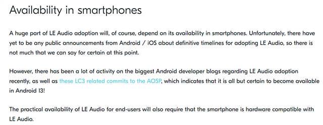

    What I'm asking is that how to make the existing mobile phones supporting LE Audio? Just need to upgrade the software(Android/IOS,or firmware for  Bluetooth chip),right? (Of course, the original hardware should support BT5.0 and above.)
    Maybe the blog is more clear to this topic.

    Yes. The full LE Audio specification was finally released last week, and with that the work can begin to incorporate it into consumer devices. For instance, Android 13 will have full support for LE Audio, and so all devices which have a chipset capable of LE Audio that are upgraded to Android 13 will support LE Audio.
    I would personally assume that this is the case for non-android devices as well, but I have yet to see any official confirmations of this anywhere yet.
