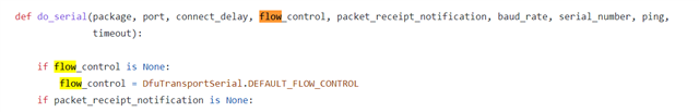

hi support team,
customer have one question about nrf dfu with serial:" how to disable flow control for 2 wire uart".
previously we have one ticket :"https://devzone.nordicsemi.com/f/nordic-q-a/28077/sdk-13-0-0-secure-serial-dfu-without-flow-control" that works fine for previous nrfutil version, and now i found that  there is no such file named "nordicsemi\dfu\dfu_transport_serial.py" in python3.9;
and how can i close the flow control?
Thanks in advance!
