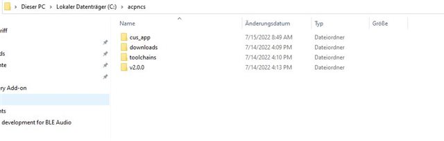

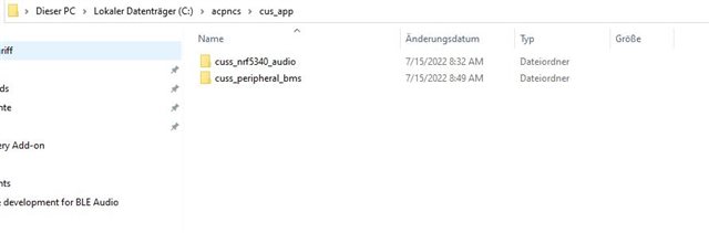

I am trying to work with nrf5340 Audio DK. I was able to run and flash the "nrf5340 Audio" application to three of my DKs (2 headsets and 1 gateway) three days back. Then there was some issue and I was not able to build. I then deleting all the data and reinstalling the Nrf Connect for Desktop, Toolchain Manager and VSCode. I did an automatic installation using toolchain manager. Still I am not able to build the application properly.
This is how my files are located/alligned.
