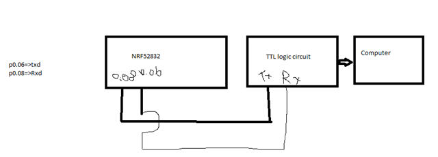

  • Hai Kenneth,
    static void uart_init(void)
    __LOG(LOG_SRC_APP, LOG_LEVEL_INFO, "----- UART ----------------------------\n");
    uint32_t err_code;
    .rx_pin_no = RX_PIN_NUMBER,
    .tx_pin_no = TX_PIN_NUMBER,
    false,
    false,
    //.rts_pin_no = RTS_PIN_NUMBER,
    //.cts_pin_no = CTS_PIN_NUMBER,
    .flow_control = UART_HWFC ,
    .use_parity = false,
    #if defined (UART_PRESENT)
    .baud_rate = NRF_UART_BAUDRATE_115200
    #else
    .baud_rate = NRF_UARTE_BAUDRATE_115200
    UART_RX_BUFF_SIZE,
    UART_TX_BUFF_SIZE,
    NULL,//uart_event_handle_custom,
    APP_IRQ_PRIORITY_LOWEST,
    err_code);
    __LOG(LOG_SRC_APP, LOG_LEVEL_INFO, "----- UART initiated successfully -----\n");
    uart_init();
    //uint32_t err_code;
    app_uart_put('p');
    My code executing successfully
    and while seeing the TTL LOgic Circuit terminal the data was not displaying
    Best Regards
    venkatraaman
  • You have connected ground also? Is the voltage level on RXD and TXD within the same level (<0.3V difference)?
    Kenneth
  • No, I have not connected the GND pin of the Nrf board to the GND pin of the TTL logic circuit board
    Should I need to connect?
    Venkatraaman J S
