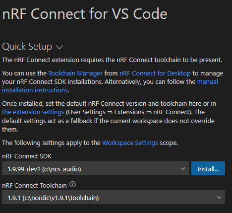

  • Hello rory and snowuyl,
    Is this causing you any issues when you attempt to build a project later on? Is there any complaint about missing packages or incorrect packet versions?
    In general I would recommend that you make use of virtual environments to make sure that you differentiate between the two different toolchains and their requirements.
    The easiest and recommended way of doing this is to use the nRF Connect extensions for Visual Studio code, which lets you effortlessly change between the different toolchains, without having to manually run the requirement scripts or west updates in-between each usage.
    Changing between different toolchains is as easy as selecting it from this dropdown menu:
    When you open a new nRF Terminal (ctrl + shift + p, type 'shell') in VSC it will source the environment for the toolchain chosen in this dropdown menu.
    Additionally, you could then download and setup the SDK and toolchains using the Toolchain Manager application from nRF Connect for desktop, which is by far the easiest way to manage your toolchains :)
    Karl
