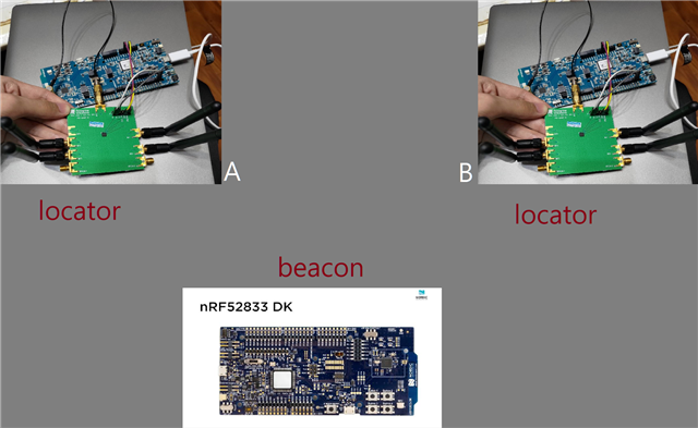

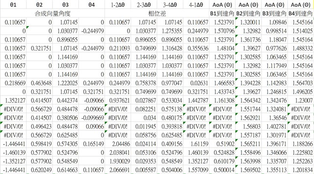

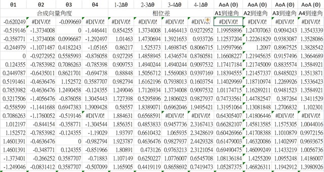

Does the raw IQ value need to go through any processing? The calculated result is not correct with the actual angle

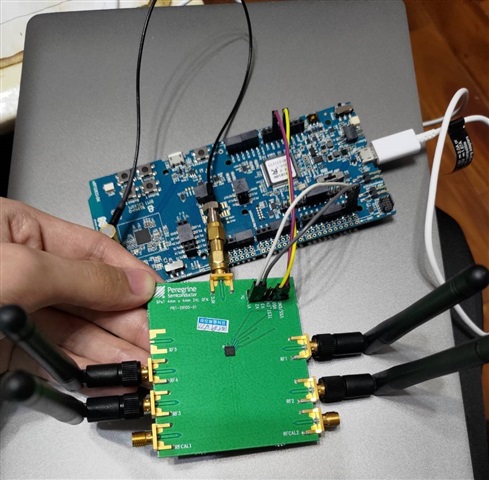

Environment introduction:
1. Use software SEGGER Embedded Studio for ARM (Nordic Edition) V5.50a.
2. 52833-DK*3 And EK42442ds*2
3. Switch order ANT1>ANT2>ANT3>ANT4
4. Start calculating

4.1.
step1. θ1 θ2 θ3 θ4 ATAN(Q/I)...
step2. Δθ= |(θ1-θ2)| ... |(θ2-θ3)| ... |(θ3-θ4)| ... |(θ4-θ1)|
step3. last = arccos (∆θλ / 2πd)
Locator_A
A
Locator_B
This doesn't look like the actual angle
Where have i went wrong?
