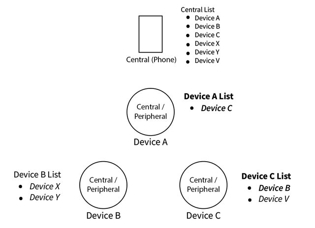

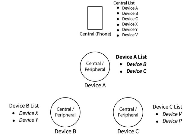

    Here's a diagram I hope will clarify what I'm trying to do:
    Let's say I have 3 identical devices, Device A, B, & C. They have the same code, same name, same services, same everything.  For this example let's say Device A will be connected to the Phone and act as a Central to other devices. It will create a list of it's connected devices and pass it to the phone (the same way the aggregate example does).

    In this way Device A only creates the list of devices connected directly to it. So in the diagrams above it would only pass Device B & C, or it would only pass Device C. Correct?
    I would like to forward the additional device lists thru each corresponding device until it reaches Device A and then passes the list along to the phone (as the Central List shows in the diagram above).
    The phone should receive the list and should be able to send commands back to each device individually. For example I want to use the phone to blink a light on Device X. How would I go about this?
    Is it simply a matter of somehow merging the lists as it goes thru each device?
    Is there an example that shows how to forward information thru multiple devices to reach the Central/Phone?
    Would it require creating a new client / server service?
    Any direction would be appreciated. Thx.
    Device A will be acting as Central for both B&C while it will be peripheral to the Phone. Is this right? If so, it is possible. The example I pointed in my last reply is a good starting point, where the device works as both central and peripheral at a time.
    From the image I can see that most devices have multiple connection and will also act as both central and peripheral. In this case you need to think about the data throughput which is the number of packets which can be transmitted in one connection event.

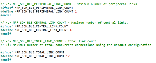

  • Hi Tai,
    The short answer is, it's possible by design, they made it so it functions this way.  And while it is diverse and flexible, the nRF52 programming seems to be equally confusing...lol. I completely understand your dilemma.
    I think the first thing is to take a look at the sdk_config.h file included with the ble_aggregator example. You'll notice a section with this information..
    These settings control how many links each device will have. So, as you can see, the NRF_SDH_BLE_PERIPHERAL_LINK_COUNT is set to 1. That means the device will act as a peripheral to one central (aka phone, in this case).
    The NRF_SDH_BLE_CENTRAL_LINK_COUNT is set to 16. That means the device will act as a central to 16 peripheral devices.
    The NRF_SDH_BLE_TOTAL_LINK_COUNT is set to 17, which I think is pretty self explanatory. You just have to make sure you set this number correctly or it won't work.
    There is a limitation on the number of concurrent devices that can be connected. Part of that has to do with the amount of memory available.
    Next, I would probably take a look at the section in the main.c file ble_evt_hander , within the switch cases you'll find two you should take a closer look at.  BLE_GAP_EVT_CONNECTED  and BLE_GAP_EVT_ADV_REPORT.
    BLE_GAP_EVT_CONNECTED shows code for both instances where the device acts as central and peripheral.
    BLE_GAP_EVT_ADV_REPORT shows code for what to do with the information received from the (16) periperal devices . Specifically, within the on_adv_report() function.
    Also, worth looking at is the advertising_data_set() , which is the information your device will use, as it's role, as a peripheral to the phone.
    It's not a simple answer, the truth is, it requires studying the code in a bit more detail to understand "HOW" this is all done. Hopefully this helps point you in the right direction. Slight smile
