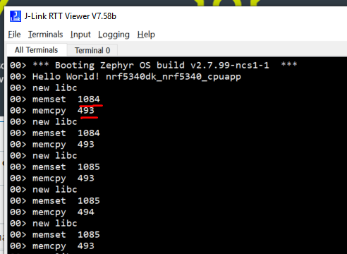

currently we found the time cost for memset has increased after the project the use NEWLIB_LIBC
inside the project , we use funcation k_cycle_get_32 to calulate the time cost for function memset & memcpy
if we enable the CONFIG_NEWLIB_LIBC the time cost:
pic1

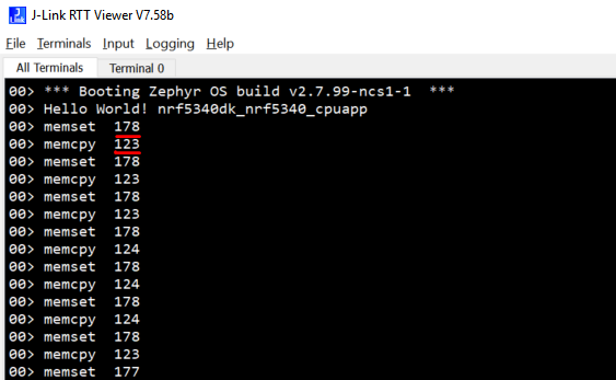

if we disable the CONFIG_NEWLIB_LIBC the time cost:
pic2
How to reproduce:
memset_issue.7z
above project could directly run in NCS 1.9.1.
If you set CONFIG_NEWLIB_LIBC=n in prj.conf, then you will pic2 result in RTT log
If you set CONFIG_NEWLIB_LIBC=y in prj.conf, then you will pic1 result in RTT log
Question:
The memset & memcpy has high frequtly used in customer's project , and they need NEWLIB_LIBC to supprot their algorithm
Is it possilbe to reduce the time cost for func memset when the project use the NEWLIB_LIBC?
