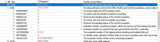

I am trying to port a project to an NRF52810.  The project uses a bootloader with a modified transport to work with a proprietary RF protocol.  The bootloader/app works on the nRF52833 and nRF52840 with different build configurations.

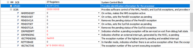

The hard fault occurs when the app tries to jump to an interrupt.  It seems that the interrupt vectors are not being redirected correctly in the app.
Is there something else that I'm missing?
