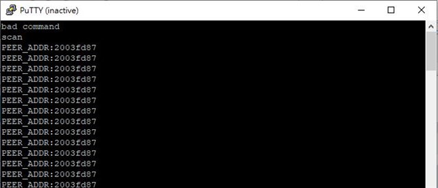

Hi everybody. I want to scan and print the address of advertising data to serial port on 52840 dongle. I set the scan filter (UUID/ ADDR/ NAME/ SHORT NAME) and
print the address in case BLE_GAP_EVT_ADV_REPORT of ble_evt_handler, and then it prints the fixed direct_addr/ peer_addr and fixed peer_addr.addr_id_peer continually
on the terminal. How can I solve it? Thank you.

  3. case BLE_GAP_EVT_ADV_REPORT of ble_evt_handler
    case BLE_GAP_EVT_ADV_REPORT:
                size_t size;
                ret_code_t ret;
                size = sprintf(m_test_buffer, "PEER_ADDR:%x\r\n", p_gap_evt->params.adv_report.peer_addr.addr);
                ret = app_usbd_cdc_acm_write(&m_app_cdc_acm, m_test_buffer, size);
                //size = sprintf(m_test_buffer, "DIRECT_ADDR:%s\r\n", p_gap_evt->params.adv_report.direct_addr.addr);
                //ret = app_usbd_cdc_acm_write(&m_app_cdc_acm, m_test_buffer, size);
            } break;
  4. Result on terminal

  • Hi
    Okay, then please explain what you want to do again, because it seems from the log like you do what you describe initially. Or am I misunderstanding something? Either way I'll need to see the piece of code where you actually do the printing as well. The main.c file would be helpful.
    Simon
  • I want to print the correct scanning mac with ADDR filter on the serial port. I try to modify the scan UUID/ ADDR/ NAME/ SHORT NAME filter and print nothing in the case NRF_BLE_SCAN_EVT_FILTER_MATCH. I try to print the peer_addr/ direct_addr in the case BLE_GAP_EVT_ADV_REPORT and I expected many difference mac but always the fixed one. Attachment is the main.c file.

            //* Billy try
                size_t size;
                ret_code_t ret;
            } break;

  • Do you have multiple advertising devices actually advertising to this or just the one? Also, do you update the data in the BLE_GAP_EVT_ADV_REPORT between each print to make sure you allow for more than the same being printed again and again.
