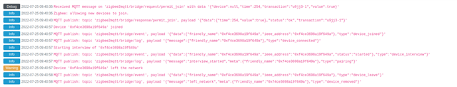

    That does seem to do something, but my device running the light switch example still fails to pair. I want to pair this to Home Assistant running the Zigbee2MQTT addon because I am most comfortable in that environment and it would be nice to see it pop up there. I have included screenshots from the device logs over RTT and the debug logs from Z2M.
    It would be useful to look at the packets that are being sent between the devices. Can you get a sniffer log of this and upload the log here as a pcap file? If you have an additional nRF52840 dongle or DK you can use nRF Sniffer for 802.15.4 for this. Please make sure to either start the sniffer before you start the coordinator so the sniffer has the network key, or share the network key with me so that I can decrypt the packets.
