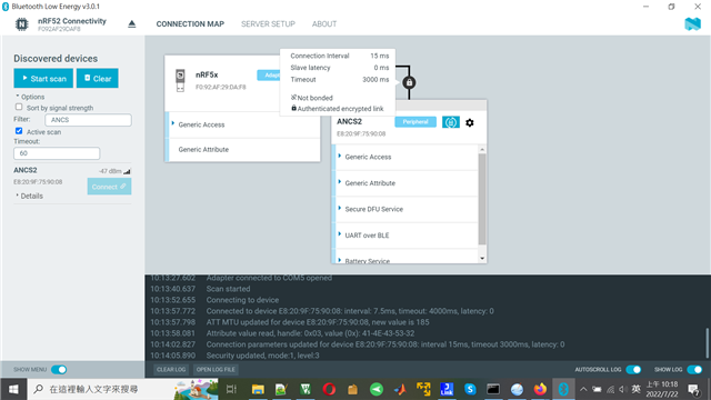

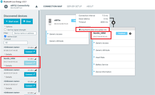

How to enable encrypted link in nRF52832 firmware?
peerManagerInit() has called pm_init() and setting security parameters. But nRF connect shows "Unencrypted link". How can I enabled encrypted link in nRF52832 firmware?
int main(void) {
peerManagerInit(true);
gapParamsInit();
  • Thanks for your reply! I have checked the ble_app_hrs example SDK17.0.2. But I can find pm_conn_secure() is called.

    /**@brief Function for the Peer Manager initialization.
    static void peer_manager_init(void)
        err_code = pm_init();
        sec_param.bond           = SEC_PARAM_BOND;
        sec_param.mitm           = SEC_PARAM_MITM;
        sec_param.lesc           = SEC_PARAM_LESC;
        sec_param.keypress       = SEC_PARAM_KEYPRESS;
        sec_param.io_caps        = SEC_PARAM_IO_CAPABILITIES;
        sec_param.oob            = SEC_PARAM_OOB;
        sec_param.min_key_size   = SEC_PARAM_MIN_KEY_SIZE;
        sec_param.max_key_size   = SEC_PARAM_MAX_KEY_SIZE;
        sec_param.kdist_own.enc  = 1;
        sec_param.kdist_own.id   = 1;
        sec_param.kdist_peer.enc = 1;
        sec_param.kdist_peer.id  = 1;
        err_code = pm_sec_params_set(&sec_param);
        err_code = pm_register(pm_evt_handler);

  • Besides, I have implemented static passkey and ble_evt_handler() as follows. From log message, "Connection secured" is printed. And nRF connect shows "authenticated encrypted link". Do I still need to call pm_conn_secure() in ble_evt_handler()?
    static void ble_evt_handler(ble_evt_t const* pBleEvt, void* pContext)
        ret_code_t errCode = NRF_SUCCESS;
        switch (pBleEvt->header.evt_id)
            case BLE_GAP_EVT_CONNECTED:
                NRF_LOG_INFO("Connected.");
                BLE_UART_SetState(BLE_NUS_STATE_CONNECT);
                errCode = bsp_indication_set(BSP_INDICATE_CONNECTED);
                if (errCode != NRF_SUCCESS) {
                    NRF_LOG_WARNING("bsp_indication_set() failed, errCode=0x%x\n", errCode);
                    return;
                m_cur_conn_handle = pBleEvt->evt.gap_evt.conn_handle;
                errCode = nrf_ble_qwr_conn_handle_assign(&m_qwr, m_cur_conn_handle);
                    NRF_LOG_WARNING("nrf_ble_qwr_conn_handle_assign() failed, errCode=0x%x\n", errCode);
                    return;
    #if PASSKEY_ENABLED
                ble_gap_sec_params_t secParam;
                securityParametersGet(&secParam);
                //secParam.bond           = SEC_PARAM_BOND;
                //secParam.mitm           = SEC_PARAM_MITM;
                errCode = sd_ble_gap_authenticate(m_cur_conn_handle, &secParam);
                    NRF_LOG_WARNING("sd_ble_gap_authenticate() failed, errCode=0x%x\n", errCode);
                    return;
                if (fstorageGetState() == FSTORAGE_STATE_ERASED) {
                    fstorageWaitUpdateRecordFinish();
                NRF_LOG_INFO("Disconnected.");
                BLE_UART_SetState(BLE_NUS_STATE_DISCONNECT);
                m_cur_conn_handle = BLE_CONN_HANDLE_INVALID;
                NRF_LOG_INFO("BLE_GAP_EVT_SEC_PARAMS_REQUEST\n");
    #if PASSKEY_ENABLED
                errCode = sd_ble_gap_sec_params_reply(m_cur_conn_handle,
                                                      BLE_GAP_SEC_STATUS_SUCCESS,
                                                      &secParam,
                                                      NULL);
                    NRF_LOG_WARNING("sd_ble_gap_sec_params_reply() failed, errCode=0x%x\n", errCode);
                    return;
            case BLE_GAP_EVT_AUTH_STATUS:
                NRF_LOG_INFO("BLE_GAP_EVT_AUTH_STATUS\n");
    #if PASSKEY_ENABLED
                if (pBleEvt->evt.gap_evt.params.auth_status.auth_status != BLE_GAP_SEC_STATUS_SUCCESS) {
                    errCode = sd_ble_gap_disconnect(m_cur_conn_handle,
                        NRF_LOG_WARNING("sd_ble_gap_disconnect() failed, errCode=0x%x\n", errCode);
                        return;
                NRF_LOG_INFO("PHY update request.");
                ble_gap_phys_t const phys =
                    .rx_phys = BLE_GAP_PHY_AUTO,
                    .tx_phys = BLE_GAP_PHY_AUTO,
                errCode = sd_ble_gap_phy_update(pBleEvt->evt.gap_evt.conn_handle, &phys);
                APP_ERROR_CHECK(errCode);
            } break;
            default:
                // No implementation needed.
