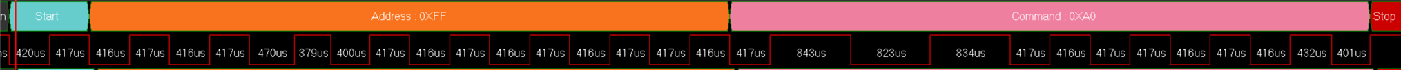

I am trying to build a Dali driver for the nRF52 with nRF Connect SDK. In the current approach, the Dali signal is send on the bus with a bit-banging approach using Zephyr's GPIO library and an nRFx timer. To summarize Dali, the data is sent with a baud rate of 1200 bps, and the data is manchester encoded (the data 1's and 0's are encoded in rising and falling edges). Dali specifies that a half-bit should be between 400µs and 433.3 µs (typically 416.7µs), and a double half-bit between 800µs  and 866.7µs (typically 833.3µs).
However, I have trouble getting the timing right. Most edges are correct. However, sometimes an edge deviates and is sent outside the window (see image below), and with quite a big amount (up to 30µs). But which edge deviates (if any), is random. To ensure nothing is interrupted
The sample from the image is measured with a logic analyzer sampling at 1MHz, connected directly to the tx of the nRF52833DK. I verified with an oscilloscope that slope of the signal is correct.
In the background, Bluetooth mesh is running, but in this test it is not actively used (I also tried disabling Bluetooth, but no difference).

To ensure nothing interrupts the timer, I used `IRQ_ZERO_LATENCY` for this test. But it surprises me that despite this, some edges deviate from the timer while most are spot-on.
Does anyone know if I did something wrong here?

  • I suspect some house keeping by the zephyr rtos that cause delay to the timer execution. Using nrfx directly I suspect will give the same result, though maybe a bit less both in terms of delay caused and the occurance rate.
    But if you were to prepare next pin toggling by configuring a gpiote task and a timer CC[] event that would trigger the gpiote task, then I don't really see any way that should fail, since you can then prepare (from your description) up to 400us before it needs to be triggered. The CC[] event that triggered the GPIOTE toggle can also be for the next TIMER interrupt.

  • Hi Kenneth,
    Thanks for the quick response. I created a toggling GPIOTE task and connected it to a timer cc event, and I got very accurate results (<100ns).
    To send two half-bits of the same value in a row, I used the timer cc event to disable the PPI channel that connects the two and re-enable it in the next event.
