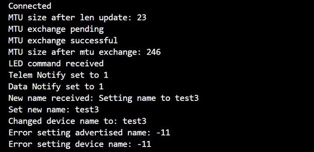

When invoked, function fails, returning error code -11    From errno.h        #define EAGAIN 11       /**< No more contexts */

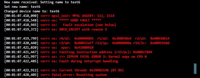

Here is a screen capture of the RTT console output during that time:
If I set a breakpoint to try to step through, I get an exception:
I suspect this is due to some real-time interaction with the BLE stack, so I think the error code message is what I need to resolve.

  • The hardfault gave the faulting instruction address. Can you check in your .map file what function exists there. What is the context in which you are calling newBleAdvName?
  • Hi Susheel,
    Thanks...
    The hardfault only occurs when I insert breakpoints (attempting to debug), so I think this is associated with BLE realtime issues being violated.    But the hardfault address points to:
    0x38 modules/nrf/subsys/mpsl/init/lib..__nrf__subsys__mpsl__init.a(mpsl_init.c.obj)
    newBleAdvName is called due to a characteristic being written to the device (from the central) that assigns a new device name to the device.    So it is called from a "characteristic written" callback in the device.    This is the expected behavior, but the calls to bt_set_name and bt_le_adv_update_data return -11.     I'm not sure what the "No more contexts" indicates.

  • CktDesigner said:
    Does advertising have to be active for "bt_le_adv_update_data" to execute successfully?   Is this what the "context" error refers to?
    It is technically not required for the advertiser to be active (as per spec) to update the adv data while advertiser is not running. But in our solution, when you start advertiser using  bt_le_adv_start, you need to give adv data anyways to this function. So there is no point in updating the adv data when adv is not active/running.
    The if condition in question was only making sure that this logic applies that there is no point in updating adv data when adv is not running since you need to update it anyway when you start advertiser. But, I see absolutely no harm in commenting out this check.
  • I had this same issue when calling bt_le_adv_update_data() from a connection disconnect callback.
    You don't need to edit the SDK source code - the problem can be fixed by running the call to bt_le_adv_update_data() in a workqueue thread. I'm not sure if this works because it run in the desired context, or whether it works because it introduces a delay.

  • We had a similiar issue, and using a workqueue thread solves it.
    However, I'm very anxious to understand _why_ it works, and whether our customers can rely on it. Do you have any light to shed here ?
    Edit: We found the source of our issue. Calling `bt_le_adv_update_data()` consumed the remaining stack of the calling thread. Putting it in a workqueue gave it a separate stack, and that solved the issue. Increasing the stack size of the calling thread also solved it. You might perhaps have had a similar issue .
