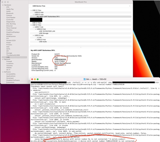

It seems `nrfutil` is unable to detect my Dev Kit using the `--serial-number` arg (I don't think I can use `--p` since my App doesn't expose a virtual Serial Port, just USB DFU Trigger interface, as I'm not using USB for anything else in my App, except DFU Trigger).
The only modification I made to the DFU Trigger Library is changing the way DFU is entered: writing GPREGRET (which is also used by BLE Buttonless) instead of toggling the RESETPIN.
I'm calling "nrf_dfu_trigger_usb_init()" before "ble_stack_init()" in my main. Since I'm able to see my device in macOS "System Information" USB tab, I'm assuming the DFU Trigger interface is properly enumerated.

    • I tried putting a breakpoint in dfu_trigger_evt_handler() and it does not trigger; the DK does not reboot into Bootloader DFU when I run nrfutil (see the tool error message from the screenshot in my initial post).
    • Yes, I did modify the dfu_trigger_evt_handler() to write GPREGRET and then trigger a soft reset to enter DFU. I also modified the Bootloader to enable GPREGRET as a DFU entry mode.
    • I am able to perform a DFU update if I enter Bootloader DFU using Button4+RESET using the command: "./nrfutil dfu usb-serial -pkg AppUpdateFile.zip -p /dev/tty.usbmodemF40B1429CE201"
    • Yes, app_usbd_serial_num_generate() is called in the App (in the DFU Trigger Library, nrf_dfu_trigger_usb.c)
    I think nrfutil isn't properly detecting the USB DFU Trigger interface. When FW App is running, I do see my DevKit in the "USB Device Tree" in macOS (see screenshot in my initial post), however I do not see any serial port in /dev/tty.*, I'm not sure if this is expected.
    Is the DFU Trigger Library supposed to expose a virtual COM port? If so -- and since I'm unable to see the virtual COM port under /dev/tty.* -- maybe my project is missing some defines in sdk_config.h ?

  • Hi Hung, thanks for your help. I forgot to update the thread after I found a solution. My issue was that I used the same USB VID/PID as the Bootloader example, in my App. I believe that was causing the `nrfutil` tool to get confused and failed.
    Changing the PID to something else (rather than 0x512f) fixed the issue for me
