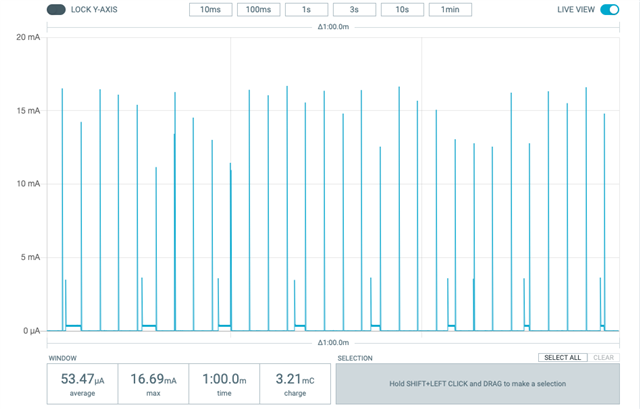

I am compiling the iBeacon example from Zephyr (nrf-sdk 1.9.0), with only one modification to increase the advertising interval to 5000-6000ms. I have a custom nrf52811 board that has no semiconductors other than the nrf52811, and I am measuring the power using the PPK2. The floor current (at 3.3V) is 2-3uA as expected, and I get a spike up to ~15mA every 5 seconds which is also expected. However, there are strange multi-second events where the device is drawing many hundreds of uA, and I can't work out what they are from. I have attached a screenshot of the PPK2 output:
I have disconnected the programmer by unplugging it.
Could you please help me understand what these events are? I have attached my code.
