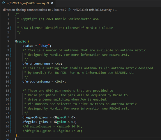

Nrf52833dk_nrf52833.overlay file is at below

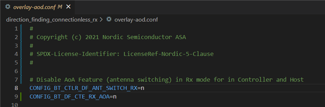

I was expecting to see overlay-aoa.conf file. Because I use rx . Am I wrong ?
There is overlay-aod.conf file and you can see at below

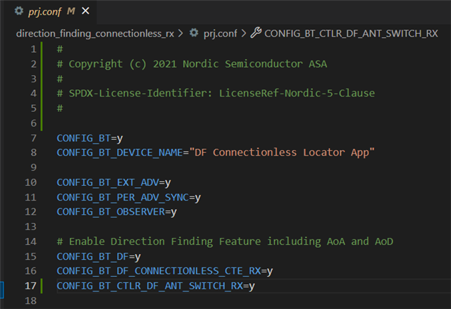

Prj.conf file is at below

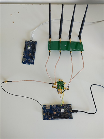

Here in general
  • I am using 4 antenna with switching circuit.

    nrf52833.overlay

    overlay-aod.conf is coming as a default for rx example. Is it correct? I already tried to change with aoa version(no result).

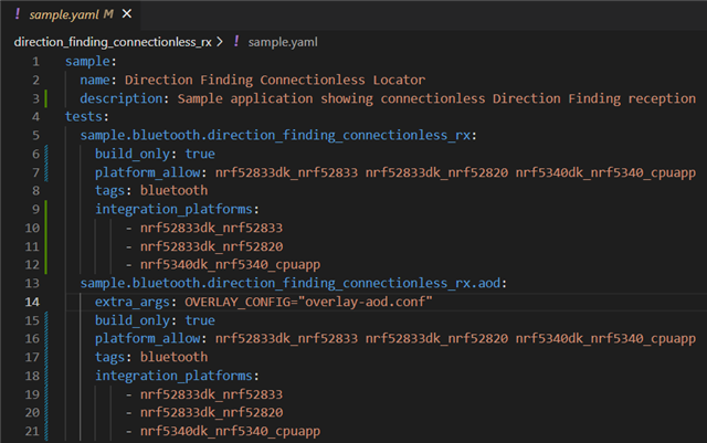

    sample.yaml

    Can you add these lines to prj.conf file and evaluate the results again?
    CONFIG_BT_CTLR_DF=y
    CONFIG_BT_CTLR_DF_ANT_SWITCH_RX=y
    CONFIG_BT_CTLR_DF_SCAN_CTE_RX=y
    There is no overlay-aoa.conf file, by default it will be AoA and switching to AoD needs using an extra overlay file.
