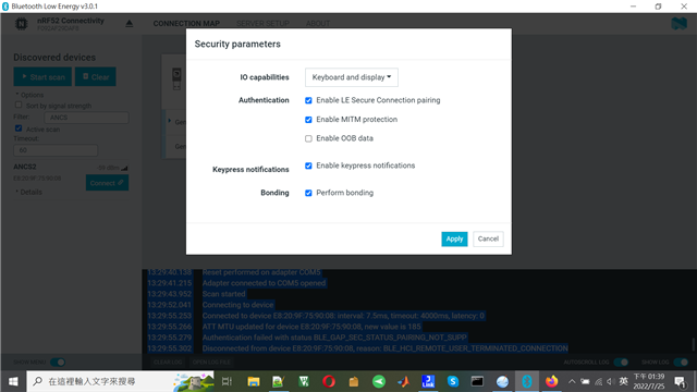

nRF52832 pm_conn_secure() return 0x3002
I have implemented bonding mechanism in nRF52832 firmware. But when I request nRF Connect to connect nRF52832 second time. nRF52832 pm_conn_secure() return 0x3002 and nRF Connect log message shows "authentication failed with status BLE_GAP_SEC_STATUS_PAIRING_NOT_SUPP".
nRF52832 log messages:

nRF Connect log messages:
13:27:42.245    Using nrf-device-lib-js version: 0.4.11
13:27:42.245    Using nrf-device-lib version: 0.11.8
13:27:42.245    Using nrfjprog DLL version: 10.15.4
13:27:42.245    Using JLink version: JLink_V7.66a
13:27:42.245    Installed JLink version does not match the provided version (V7.58b)
13:27:42.471    Updated list of uuids with data from github.com/.../v1
13:27:58.686    Selected device with s/n F092AF29DAF8
13:27:58.692    Device setup completed
13:27:58.692    Connectivity firmware version: ble-connectivity 4.1.4+Mar-11-2021-08-36-04. SoftDevice API version: 5. Baud rate: 1000000.
13:27:58.693    Opening adapter connected to COM5
13:27:59.638    Successfully opened COM5. Baud rate: 1000000. Flow control: none. Parity: none.
13:27:59.639    Reset performed on adapter COM5
13:28:00.703    Adapter connected to COM5 opened
13:28:05.416    Scan started
13:28:33.884    Connecting to device
13:28:36.201    Connected to device E8:20:9F:75:90:08: interval: 7.5ms, timeout: 4000ms, latency: 0
13:28:36.218    ATT MTU updated for device E8:20:9F:75:90:08, new value is 185
13:28:36.488    Attribute value read, handle: 0x03, value (0x): 41-4E-43-53-32
13:28:41.264    Connection parameters updated for device E8:20:9F:75:90:08: interval 15ms, timeout 3000ms, latency: 0

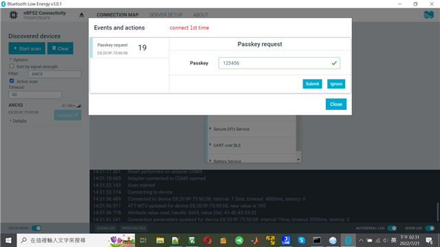

13:28:45.213    Security updated, mode:1, level:3
13:29:20.448    Security updated, mode:1, level:3
13:29:20.500    Storing bond info for device E8:20:9F:75:90:08
13:29:28.505    Device closed.
13:29:39.205    Selected device with s/n F092AF29DAF8
13:29:39.209    Device setup completed
13:29:39.209    Connectivity firmware version: ble-connectivity 4.1.4+Mar-11-2021-08-36-04. SoftDevice API version: 5. Baud rate: 1000000.
13:29:39.210    Opening adapter connected to COM5
13:29:40.137    Successfully opened COM5. Baud rate: 1000000. Flow control: none. Parity: none.
13:29:40.138    Reset performed on adapter COM5
13:29:41.215    Adapter connected to COM5 opened
13:29:43.952    Scan started
13:29:52.041    Connecting to device
13:29:55.253    Connected to device E8:20:9F:75:90:08: interval: 7.5ms, timeout: 4000ms, latency: 0
13:29:55.266    ATT MTU updated for device E8:20:9F:75:90:08, new value is 185

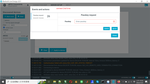

13:29:55.279    Authentication failed with status BLE_GAP_SEC_STATUS_PAIRING_NOT_SUPP
13:29:55.302    Disconnected from device E8:20:9F:75:90:08, reason: BLE_HCI_REMOTE_USER_TERMINATED_CONNECTION

  • I found sec_status is set to BLE_GAP_SEC_STATUS_PAIRING_NOT_SUPP in smd_params_reply(). So nRF Connect shows "Authentication failed with status BLE_GAP_SEC_STATUS_PAIRING_NOT_SUPP".
    log messages.
    # SEGGER J-Link RTT Viewer V6.32i Terminal Log File
    # Compiled: 15:22:50 on Jul 24 2018
    # Logging started @ 25 Jul 2022 17:00:50
     0> <info> app: Version 1.0.0
     0>
     0> <info> app: ========| flash info |========
     0> <info> app: erase unit:   4096 bytes
     0> <info> app: program unit: 4 bytes
     0> <info> app: end address: 0x7FFFF
     0> <info> app: ==============================
     0> <info> app_timer: RTC: initialized.
     0> <debug> app: NOR_DATA_PERIOD=819
     0>
     0> <debug> app: NOR_RECORD_PERIOD=8192
     0>
     0> <info> app: bsp_button_longkey_handler 0.
     0> <warning> app: Battery volage 222mV is too low
     0>
     0> <warning> app: Battery volage 42mV is too low
     0>
     0> <warning> app: Battery volage 0mV is too low
     0>
     0> <info> app: POWER_ON.
     0> <info> app: External devices initializing start
     0> <info> app: External devices initializing finish
     0> <info> app: bsp_button_longkey_handler 1.
     0> <debug> nrf_ble_gatt: Requesting to update ATT MTU to 185 bytes on connection 0x0.
     0> <info> app: PM_EVT_BONDED_PEER_CONNECTED
     0>
     0> <info> app: BLE_GAP_EVT_CONNECTED
     0>
     0> <debug> app: state=1
     0>
     0> <debug> nrf_ble_gatt: ATT MTU updated to 185 bytes on connection 0x0 (response).
     0> <debug> peer_manager_smd: smd_params_reply() e
     0>
     0> <info> app: PM_EVT_CONN_SEC_CONFIG_REQ
     0>
     0> <debug> peer_manager_smd: smd_params_reply() BLE_GAP_SEC_STATUS_PAIRING_NOT_SUPP 2
     0>
     0> <debug> peer_manager_smd: smd_params_reply() return 0x0
     0>
     0> <info> app: BLE_GAP_EVT_SEC_PARAMS_REQUEST
     0>
     0> <info> app: PM_EVT_CONN_SEC_FAILED
     0> <info> app: Faield to secure connection with handle 00
     0>
     0> <info> app: BLE_GAP_EVT_AUTH_STATUS
     0>
     0> <warning> app: sd_ble_gap_disconnect() failed, errCode=0x3002
     0>
     0> <info> app: BLE_GAP_EVT_DISCONNECTED
     0>
     0> <debug> app: state=0
     0>
     0> <debug> app: _securityRequestHandler
     0>
    ret_code_t smd_params_reply(uint16_t                 conn_handle,
                                ble_gap_sec_params_t   * p_sec_params,
                                ble_gap_lesc_p256_pk_t * p_public_key)
        NRF_LOG_DEBUG("smd_params_reply() e\n");
        NRF_PM_DEBUG_CHECK(m_module_initialized);
        uint8_t              role       = ble_conn_state_role(conn_handle);
        ret_code_t           err_code   = NRF_SUCCESS;
        uint8_t              sec_status = BLE_GAP_SEC_STATUS_SUCCESS;
        ble_gap_sec_keyset_t sec_keyset;
        memset(&sec_keyset, 0, sizeof(ble_gap_sec_keyset_t));
        if (role == BLE_GAP_ROLE_PERIPH)
            // Set the default value for allowing repairing at the start of the sec proc. (for peripheral)
            ble_conn_state_user_flag_set(conn_handle, m_flag_allow_repairing, false);
        if (role == BLE_GAP_ROLE_INVALID)
            return BLE_ERROR_INVALID_CONN_HANDLE;
    #if PM_RA_PROTECTION_ENABLED
        if (ast_peer_blacklisted(conn_handle)) //Check for repeated attempts here.
            sec_status = BLE_GAP_SEC_STATUS_REPEATED_ATTEMPTS;
        else
    #endif // PM_RA_PROTECTION_ENABLED
        if (p_sec_params == NULL)
            // NULL params means reject pairing.
            sec_status = BLE_GAP_SEC_STATUS_PAIRING_NOT_SUPP;
            NRF_LOG_DEBUG("smd_params_reply() BLE_GAP_SEC_STATUS_PAIRING_NOT_SUPP 1\n");
        else
            if ((im_peer_id_get_by_conn_handle(conn_handle) != PM_PEER_ID_INVALID) &&
                (role == BLE_GAP_ROLE_PERIPH) &&
                !allow_repairing(conn_handle))
                // Bond already exists. Reject the pairing request if the user doesn't intervene.
                send_config_req(conn_handle);
                if (!allow_repairing(conn_handle))
                    // Reject pairing.
                    NRF_LOG_DEBUG("smd_params_reply() BLE_GAP_SEC_STATUS_PAIRING_NOT_SUPP 2\n");
            if (!p_sec_params->bond)
                // Pairing, no bonding.
                sec_keyset.keys_own.p_pk  = p_public_key;
                sec_keyset.keys_peer.p_pk = &m_peer_pk;
            else if (sec_status != BLE_GAP_SEC_STATUS_PAIRING_NOT_SUPP)
                // Bonding is to be performed, prepare to receive bonding data.
                err_code = sec_keyset_fill(conn_handle, role, p_public_key, &sec_keyset);
        if (err_code == NRF_SUCCESS)
            // Everything OK, reply to SoftDevice. If an error happened, the user is given an
            // opportunity to change the parameters and retry the call.
                err_code = sd_ble_gap_sec_params_reply(conn_handle, sec_status, p_sec_params, &sec_keyset);
            else
                err_code = sd_ble_gap_sec_params_reply(conn_handle, sec_status, NULL, &sec_keyset);
        NRF_LOG_DEBUG("smd_params_reply() return 0x%x\n", err_code);
        return err_code;
    Error 0x3002 means BLE_ERROR_INVALID_CONN_HANDLE .
    Please check how pm_conn_secure() is called.
    I've noticed that you have opened quite a few support cases regarding the same issue on pairing. Please try to focus on one ticket.
    I would suggest to study the example and make as few modification as possible.
    Which device you used on the central side ?

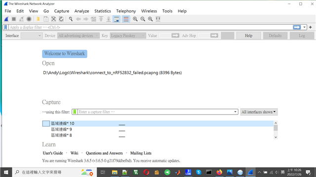

    Please try to capture a sniffer trace.
