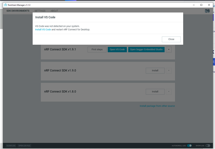

  • Thanks Jared,
    installed the VSCode Community 2019, updated the tool chain, however, not sure how to install the nRF Connect VS Code extension. I guess it is done automatically, anyway, if I want to open the new nRF Connect SDK via the toolchain the following error appears , see the pic, any ideas what am I doing wrong?
     Best.
    You need to install VS code from here
    Can you double check that it's already installed?
    regards
