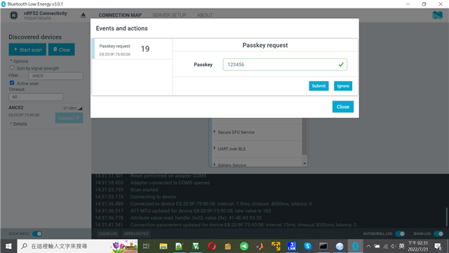

When I use Windows nRF Connect to connect to nRF52832 device. It pop up window for user to enter passkey. But When I use iOS nRF Connect to connect to nRF52832 device. It doesn't pop up window for user to enter passkey and failed to connect to nRF52832 device.

    nRF52832 log messages for Windows nRF Connect:
     0> <debug> nrf_ble_gatt: Requesting to update ATT MTU to 185 bytes on connection 0x0.
     0> <info> app: Connected.
     0> <debug> app: state=1
     0>
     0> <debug> nrf_ble_gatt: ATT MTU updated to 185 bytes on connection 0x0 (response).
     0> <info> app: BLE_GAP_EVT_SEC_PARAMS_REQUEST
     0>
     0> <info> app: Connection secured: role: 1, conn_handle: 0x0, procedure: 1.
     0> <info> app: BLE_GAP_EVT_AUTH_STATUS
     0>
  • After I remove BLE device from iPhone setting, pairing with passkey is okay with iOS nRF Connect.
